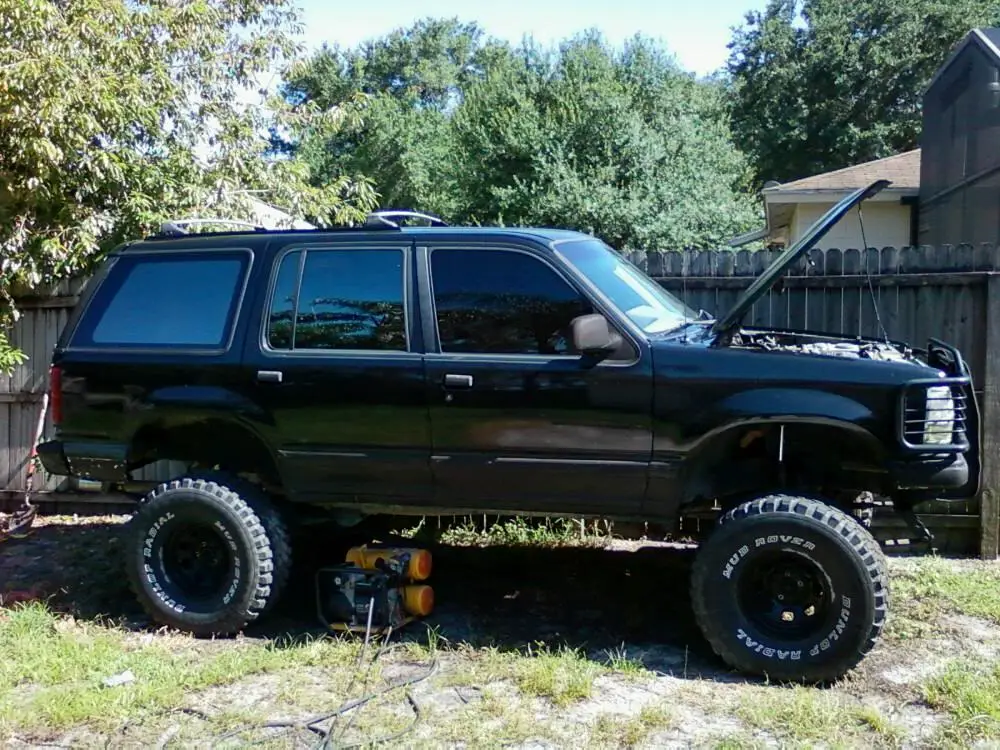

thats my baby lol i have a ton of $$ in it and i dont really want to part with it but after all this i might just sell it
it is now tweety yellow underbody
98 jeep wrangler wide front end
black craiger rims
35in mud rovers as seen in pic
5%limo tint all the way around
mild cams from summit raceing
k&n intake
being re painted black in 1 week if not sold lol
lowerd gears front and rear
led lights in rear with led brake light strip
brush gaurd that was free lol
2 bright k/c light with seprete relay so no power failures
killer jvc head deck
2 12s in a box with a 1000watt amp
last edition number nascar #3the best cb with mods
flowmaster exhaust with a dump tube right behind cat.
walboro fuel pump with 10 psi injectors
summit raceing radiator
the inside has no rips no stains and only 79*** miles org and all power all windows work
