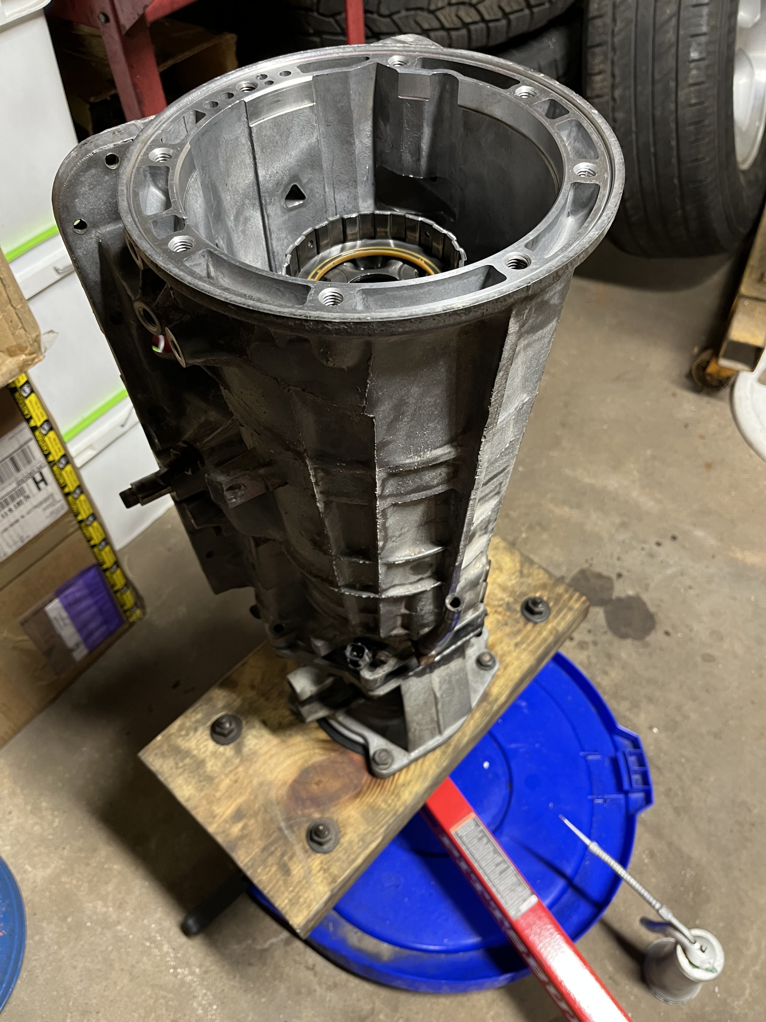

The manual lever position sensor and shaft were rusted together like usual. It is hard to get the sensor off without breaking it, the rust makes the shaft fatter and binds inside the sensor. Since I was using a new case I pulled the shaft out with the sensor still on it and used a socket to tap the sensor off the shaft. I was able to get them apart without breaking the sensor. I cleaned up the shaft and put anti seize on it.
To get the manual lever shaft out of the case you have to remove a little pin. That pin did not want to come out. I watched a couple YouTube videos and found that many people struggle with this. I ended up doing what I saw in one of the videos I watched, I drilled holes around the pin and it finally came out. Of course you could not do this to a case you are reusing, this case was already garbage from stripped valve body bolt holes.
