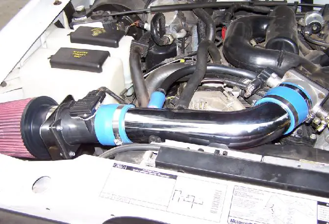

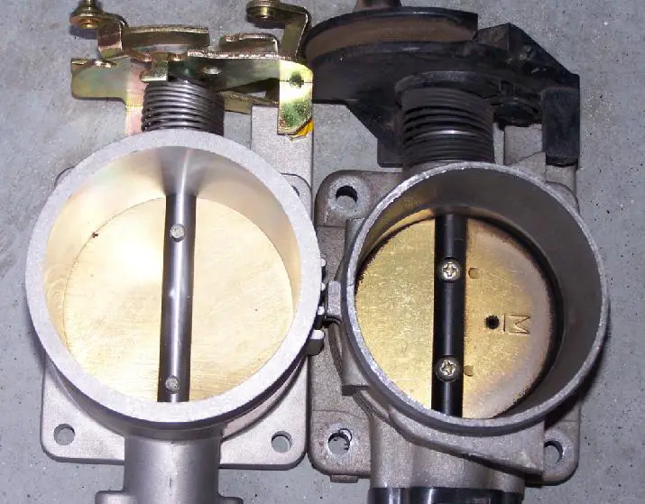

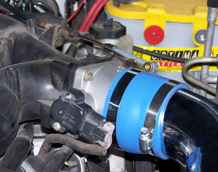

Well today I finally got around to installing a Mustang 70mm TB and a MAC Intake. The intake was $130 off ebay, and the TB was 120, also off ebay. Note that the other TB's member's have used are more expensive as they include a TPS, however I used the one I already had, and saved some coin (around $70 i believe). If the original TPS is difficult to remove, try heating the heads of the screws with a soldering iron as they are probably held in with lock-tite. This worked on one screw for me, had to cut the other one off. If you forget to get a new TB gasket like I did, you will most likely have to cut off the parts of the original gasket that make sure it only goes on one way. Also, there will be parts of the original gasket that extend into the opening, these must be on the bottom for the TB to be able to open. If that didnt make much sense, it probably will when you get the gasket off and see how it's made. The only issue I had with the MAC intake install was that the PCV hose was difficult to fit in, it just takes alot of work. Hopefully in a few weeks I'll have another post with a C&L MAF housing.

Nice looking truck. Have you noticed any improvement in performance from the intake and TB?
Definetly some better response in the lower rpms, allthough since I put both on at the same time, I cant point out which one is helping the most.
