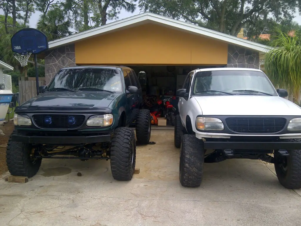

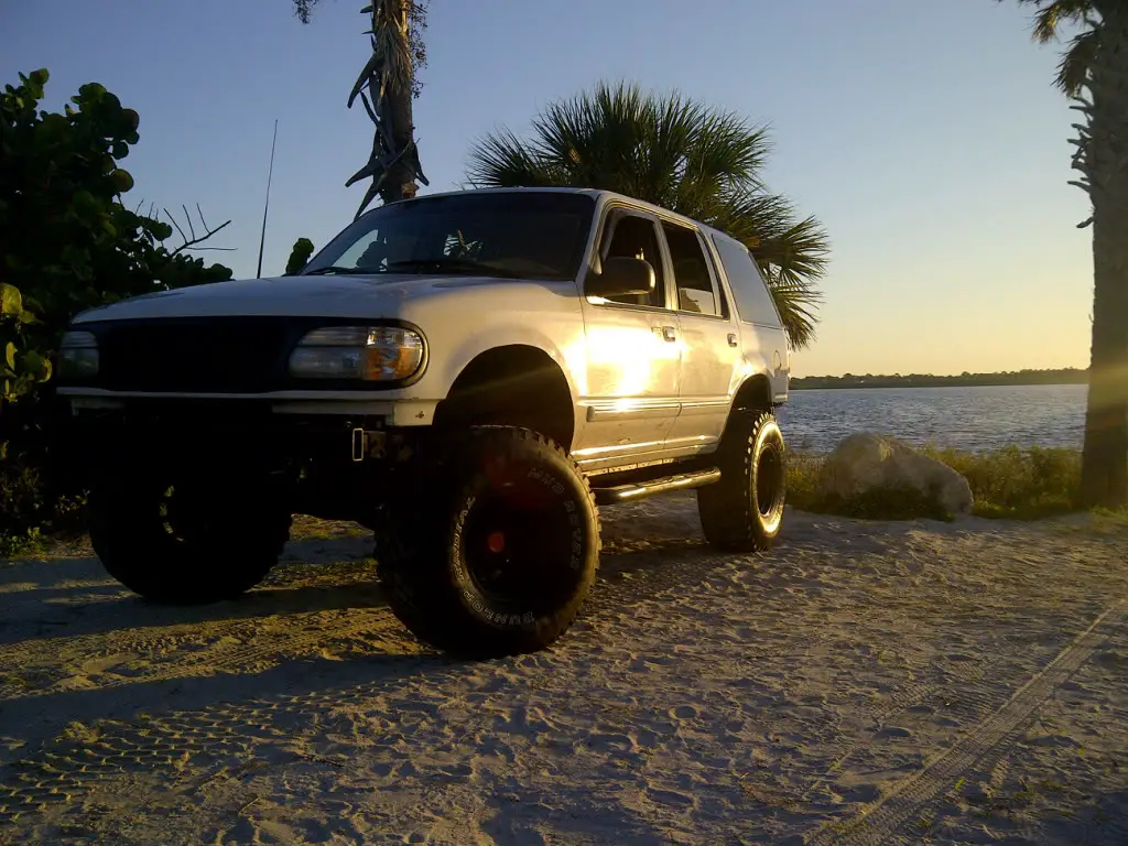

I'm insanely jealous. That thing looks fantastic, and I'm excited to get mine to look like that eventually too! Hopefully by the year's end I'll have my axle ready and the other stuff. Everything would be best, but I'm doubting I'll be able to get the cash to afford the axle set up and the spindles by year's end.

Those both look great! I'm not sure which I'd choose...probably the SAS'd cause it's 4wd, but yours would be so much easier to maneuver in parking lots since it isn't like a foot wider on each side. haha But good job on your truck man! It looks great!
