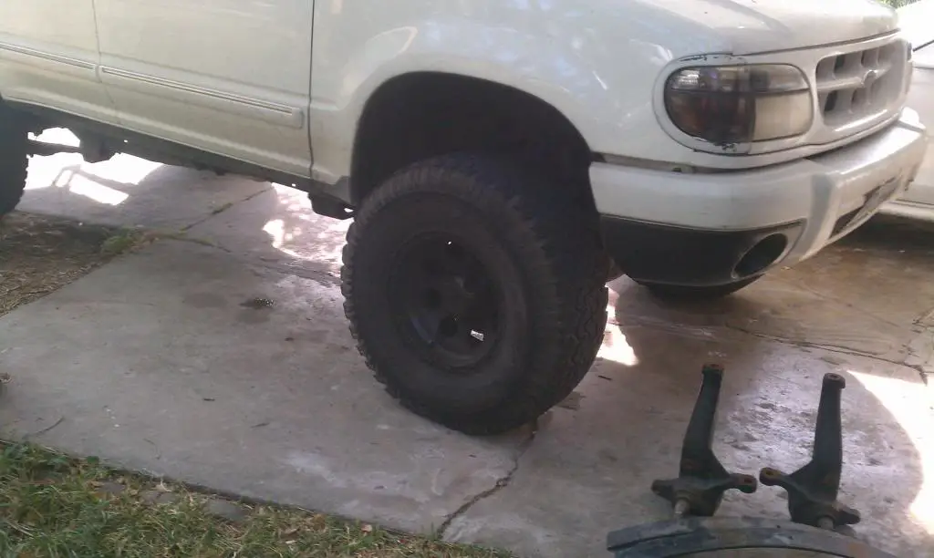

a set of fabtech spindles and aaleafs off craigslist make my 2wd pretty sweet even tho im dreaming of a 4wd monster..... $160 bucks wth not
still on 33's but i will find a deal on something soon

Mine are fabtech I found on craigslist for 160. They are made for a ranger and when you call fabtech they will tell you it wont work on torsion bars. The guy who takes care of that wasn't around when guys were doin this 10 years ago. But I found an old download that showed the exact lower control arm mod for them to work(I can post it, if need be). Which I am fairly positive has to be done on all of them made by different companies. But hey Im a plumber not a mechanic so what do i know anyway:navajo:
Oh and for the record the rear is a set of skyjacker soft ride 6" lift leafs that did not meet my expectations but is at the right height. I had the aaleafs on for half a day before looking for other options. So i plan on doing 4.56's, s.o.a and 35-37's all at once. Then comes a solid axle and 4x4 trans............ nah i'm bull ****tin i'll drive it until im bored then sell it and start building a 4x4.
