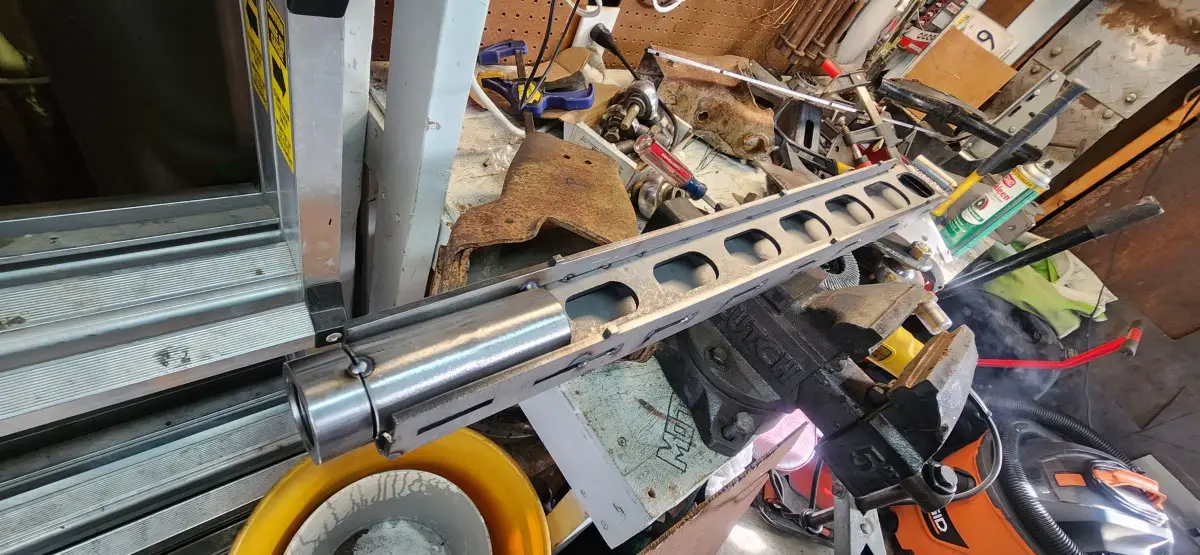

Boxed radius arms. None of the overlays are on them yet

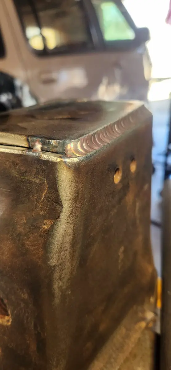

Cut D44 ends. Capping off cut end with 3/8" plate

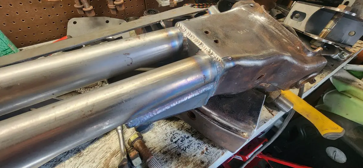

Passenger side beam getting sewn up. Tigging everything except the plates. Those will be migged up. Overlays might be Tig

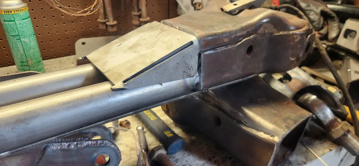

Migged out radius arms. Going to Tig the keyways to blend in
