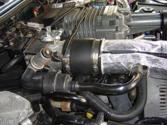

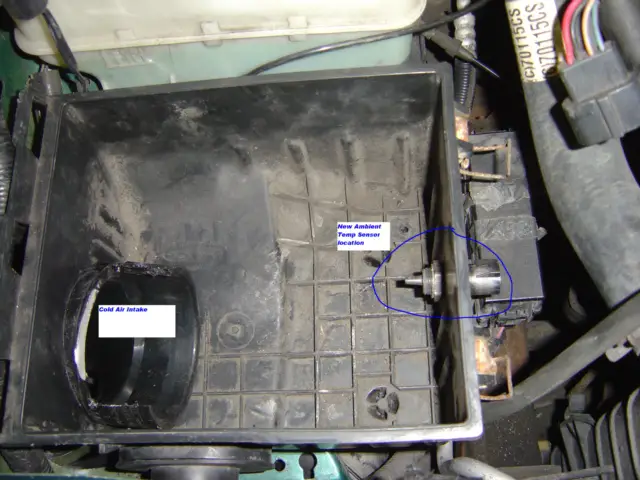

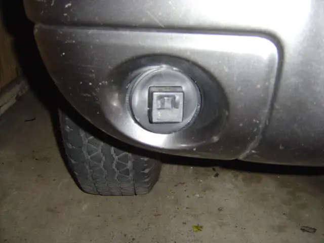

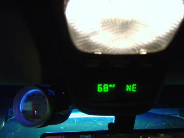

new updates
I have been busy, got some aluminum rims, custom cold air intake, new lighter bumper, relocated ambient temp sensor to air filter box,75mm throttlebody,2.8 inch supercharger pulley, and datalogged a 14.7 in a quarter mile with my automatic 4wd not working. Had a bad transfer case sensor, just fixed it in time for next weeks race at maple grove. Cant wait to weigh in and see how it does on the sticky track. used to weigh 4365(me not in it) and ran 15.3 in quarter mile.

Wheels are each 13 lbs lighter than old steel ones.
75mm Throttle body is from mustang 4.6, ebay cheapie.
Idle Air Control assembly is off a 1996 lincoln town car 4.6 from junkyard.
Bumper is 14 lbs lighter than old one and it is off a 1999 or 2000 explorer.

Cold air intake
Rain proof
Stock ambient temp sensor location

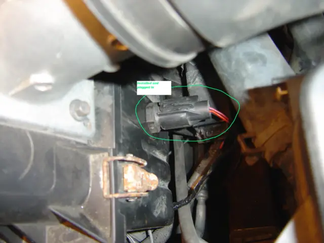

New ambient temp sensor location

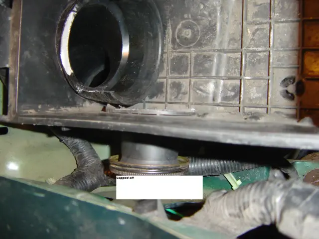

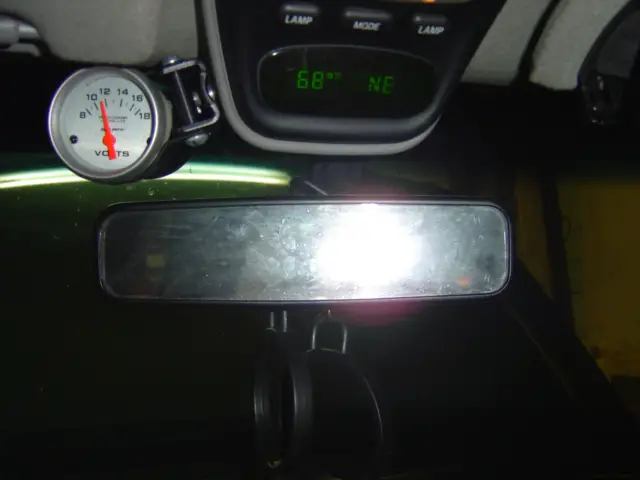

more
more pics
