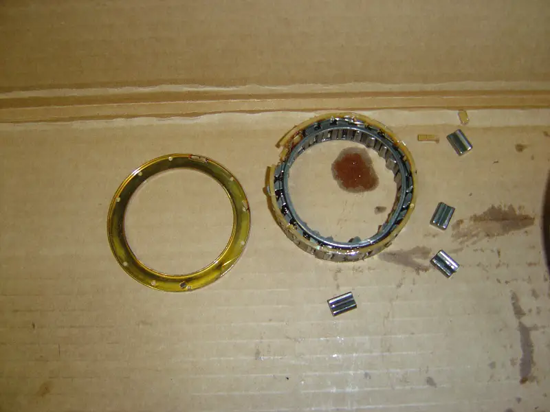

The transmission finally let loose. I was doing a 4wd burnout and really beating hard on the Ex. It was at the last race of the year at ATCO Raceway.
I had already run a 13.85 and was trying to beat that run if possible.
I saw 3,000 rpm's with all 4 tires smoking,then Drive felt like neutral. So did manual 1. Reverse worked, and so did manual 2 (which is really third gear).
4th and 5th worked so I drove it home shifting from manual 2 to Drive at higher speeds. Tore it apart to find bad sprags (one way clutches). Waiting for parts to show up so I can put it back together.
Broken Sprags

was it that big one way bearing that blew up in your trans? I think its an overdrive clutch/bearing??
Im just curious if thats the same bearing I trashed in my 5r55e a couple of years ago. Nice Job btw!
edit...sorry, not the od one way, as I lost reverse when that happened.

There are two one way sprags(clutches). I broke both.
Wished I had seen both broken the first time I removed the transmision.
LOL
I was looking for the rear one to be bad and I found that. Put it all back together and still had problems. Tore it back out, found the O/D Sprag bad as well. It was locked up between the surrounding hard parts so I didn't even know it was there. Whoops.
At least it is good now, all gears work, and no leaks.

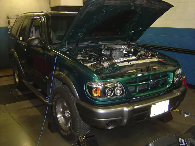

Dyno
Pics
