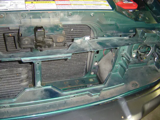

Can you do me a huge favour and snap a pic of how you mounted your intercooler radiator? I think I have mine sorted out (At least in my mind), but am always looking for ideas.
Its so darn cold here right now, I have absolutely no intention of doing any work till it warms up. Even with heaters, the garage won't get very warm.
intercooler radiators
Which one? lol.
I started with this space here.

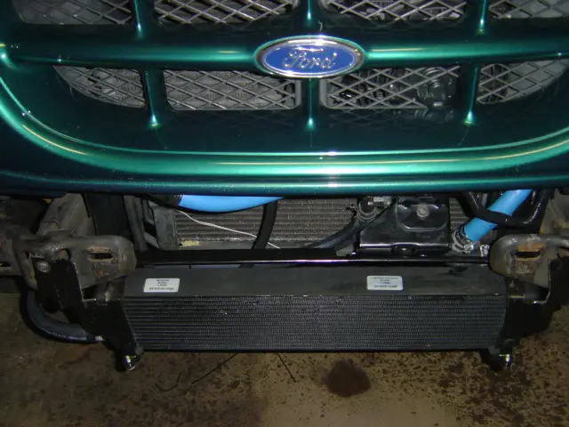

IC radiator
Then I put a fan on it and put the front back together.

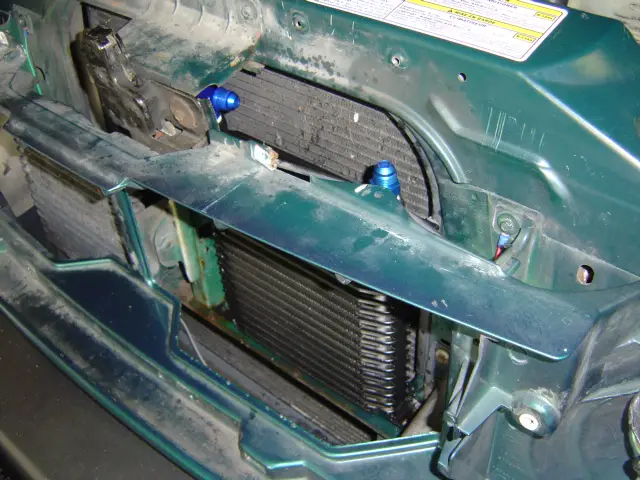

IC radiators
Then I thought, that wasn't enough. So I added this here.
