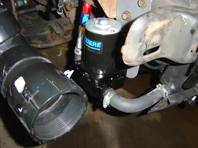

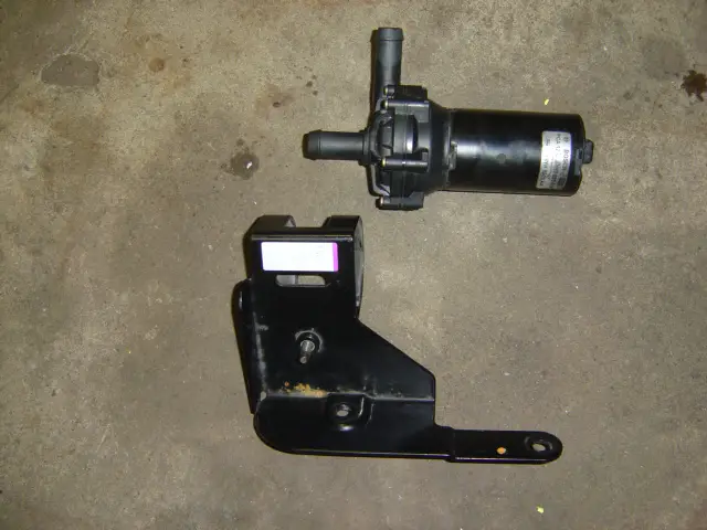

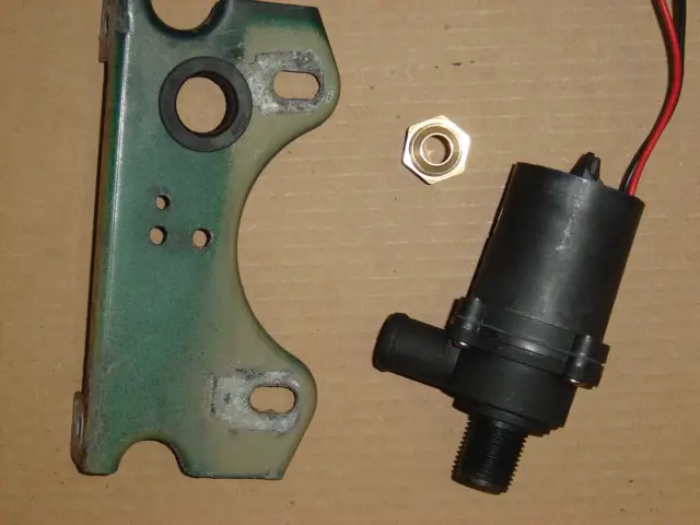

Pumps
1.crappy ebay stuff. Did not work at all. Don't waste your money
2.Ford racing. Worked a little
3.Meziere Pump. Works great but cost a lot.

LOL
No need for a tank to increase capacity, just add another intercooler radiator!
Very nice. The one I picked up is much the same dimensions as your bottom rad.
Nice job on the mounts. I'll have to try something like that.
I have the same crap ebay pump as you. I should just toss it in the bin. It's way to small to do anything/
