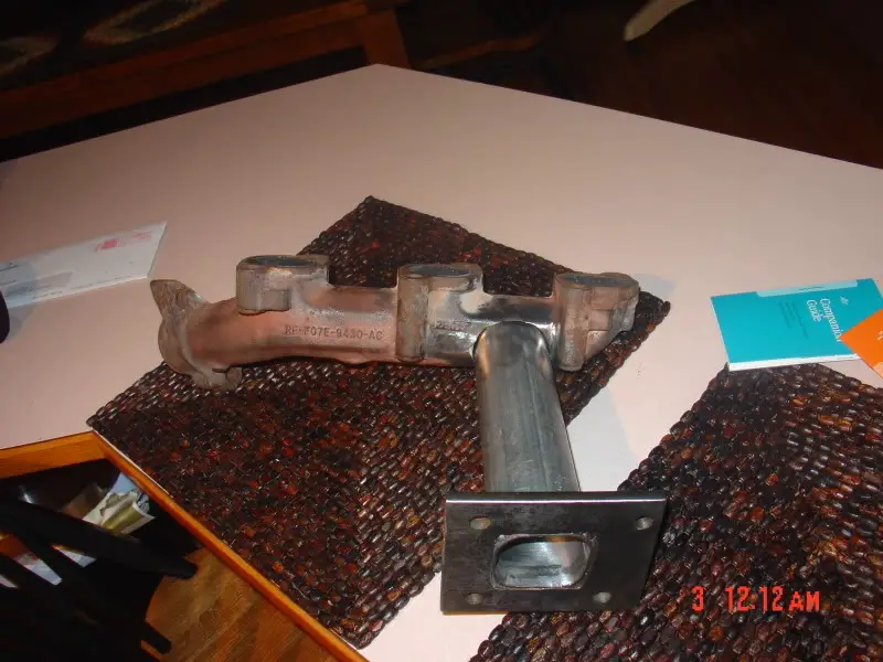

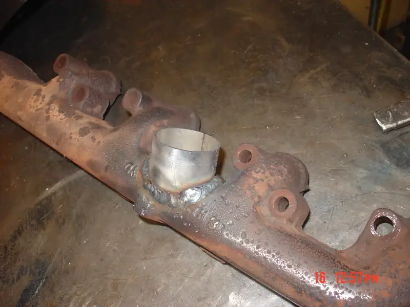

I'm going to try out the factory manifold first there's less; time, money, materials, cost.....to build these. I have welded cast to steel a few times before and they have held up. There is no point in dumping $$$$$ into a old ford explorer. if i wanted to build flanges anyways I have plenty off machines to cut them out as well. cutting out flanges still takes time, materials, and money. If the cast manifold cannot take the abuse I will look into other ways. I pre-heat the cast and burn the weld in hot. i will also be welding L gussets to the pipe and manifold for more strength and durability along with a support rod from the motor to flange.
