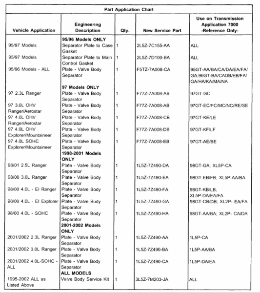

Part Application Chart
Vehicle Application Engineering Description Qty. New Service Part Use on Transmission Application 7000 -Reference Only-
95/96 Models ONLY
95/97 Models Separator Plate to Case Gasket 1 2L5Z-7C155-AA ALL
95/97 Models Separator Plate to Main Control Gasket 1 2L5Z-7D100-BA ALL
95/96 Models - ALL Plate - Valve Body Separator 1 F5TZ-7A008-CA 95GT-AA/BA/CA/DA/EA/FA/ GA;96GT-BA/CADB/EB/FA/ GA/HA/KA/MA/NA
97 Models ONLY
97 2.3L Ranger Plate - Valve Body Separator 1 F77Z-7A008-AB 97GT-GC
97 3.0L OHV Ranger/Aerostar Plate - Valve Body Separator 1 F77Z-7A008-AB 97GT-EC/FC/MC/NC/RE/SE
97 4.0L OHV Ranger/Aerostar Plate - Valve Body Separator 1 F77Z-7A008-CB 97GT-KE/LE
97 4.0L OHV Explorer/Mountaineer Plate - Valve Body Separator 1 F77Z-7A008-DB 97GT-KF/LF
97 4.0L SOHC Explorer/Mountaineer Plate - Valve Body Separator 1 F77Z-7A008-EB 97GT-AE/BE
1998-2001 Models ONLY
98/01 2.5L Ranger Plate - Valve Body Separator 1 1L5Z-7Z490-DA 98GT-GA; XL5P-CA
98/00 3.0L Ranger Plate - Valve Body Separator 1 1L5Z-7Z490-EA 98GT-EB/FB; XL5P-AA/BA
98/00 4.0L - EI Ranger Plate - Valve Body Separator 1 1L5Z-7Z490-FA 98GT-KB/LB; XL5P-DA/EA/FA
98/00 4.0L - EI Explorer Plate - Valve Body Separator 1 1L5Z-7Z490-GA 98GT-CB/DB; XL2P- EA/FA
98/00 4.0L - SOHC Plate - Valve Body Separator 1 1L5Z-7Z490-HA 98GT-AA/BA; XL2P- CA/DA
2001-2002 Models ONLY
2001/2002 2.3L Ranger Plate - Valve Body Separator 1 1L5Z-7Z490-AA 1L5P-CA
2001/2002 3.0L Ranger Plate - Valve Body Separator 1 1L5Z-7Z490-BA 1L5P-AA/BA
2001/2002 4.0L-SOHC - ALL Plate - Valve Body Separator 1 1L5Z-7Z490-CA 1L5P-DA/EA
ALL MODELS
1995-2002 ALL as Listed Above Valve Body Service Kit 1 3L5Z-7M203-JA ALL
PART NUMBER PART NAME
3L5Z-7M203-JA Valve Body Service Kit

Courtesy of Donnie Arbogast, here is a tabular listing of some of the above info.
