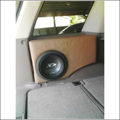

i would go with two alpine type r's like someone else said if you are going with 2 subs. if you are going the thunderform route, you can save a lot of money by making your own. look around here for pics of 2nd gen explorers that people have made their own. here is the one that i made for my 2004 ex.
