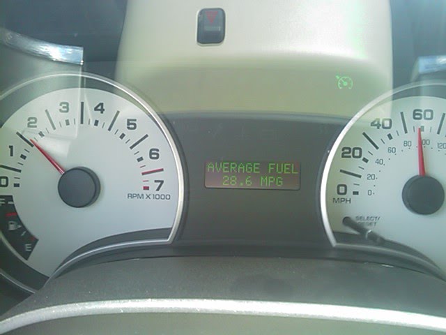

pictures were taken on the same stretch of highway 80* flat for 2 miles with a tail wind. I rest the mileage each time on the flat while cruising.
Please do not rely on the message center information as accurate fuel data. I have owned several Lincolns with the message center, and two Explorers/Mountaineers with it. That is not accurate, it's not even close.
Fuel mileage data must come from longer distances than a mile or two. The only real reliable fuel data is what you get from multiple tank fill ups.
Shoot, I've gotten 28-30mpg going to work in my Mark VII tons of times. Never mind that it's a downhill section and the message center is in error in those light throttle conditions. My real mileage with that car was about 18-21mpg, as documented by recording all fuel tank fill ups and mileage.
