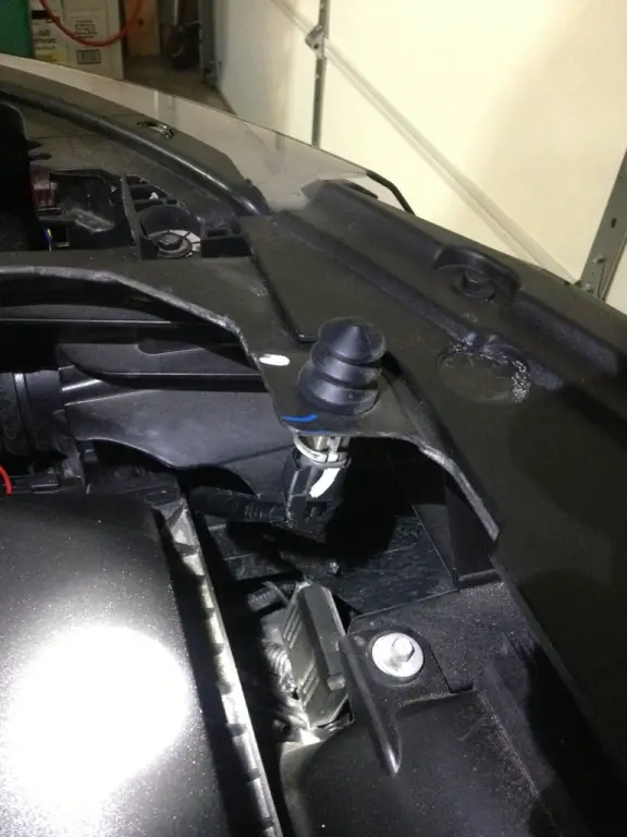

Thanks. I just ordered as set from coolbulbs. Can anyone post up a pick of where they put the ballast and how they secured it. I had the hood popped and there seems to be a couple of places where there are already threaded holes for mounting. I'll take some pics to show where I am talking about.
Here is a picture of the passenger side ballast:

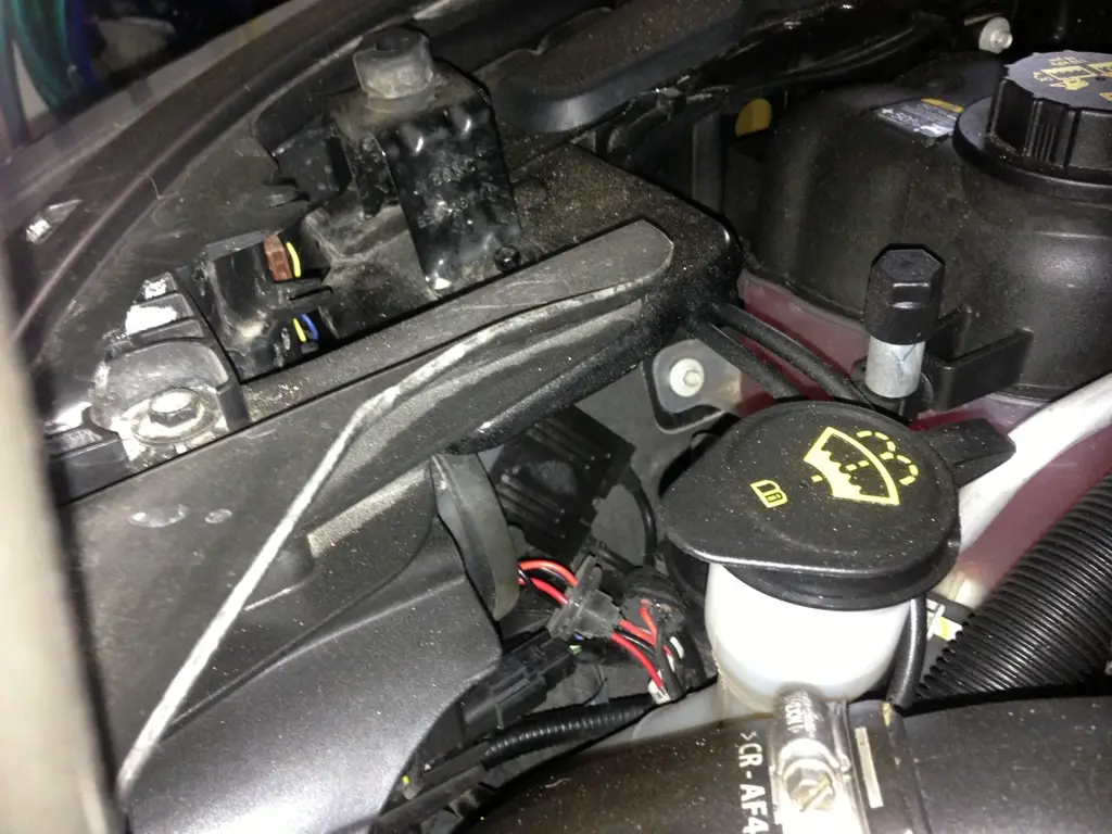

Here is the picture of the driver side ballast. I used a ziptie in one of the screw holes and ziptied it to the clip on that black wire by the ballast. Hope this makes sense. In the picture the back of the ballast is towards the front of the car.
Nice. I installed both under the front lip. They fit perfect in the slots and they are out of the way.
