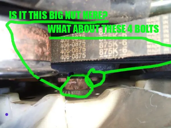

I took a picture looking down on the fan clutch from the top. Is it the big nut in the center? The fan shroud said it's right hand thread. That means turn it counter clockwise to loosen it?
I was reading that there's some special wrench to do this. I will also be taking off and replacing the water pump It's looking like it'll be around $160 for a total fix. Not bad since there's no labor involved....other than mine. :thumbsup:
The big nut is the one your lookin for...righty tighty, lefty loosey...
The smaller ones hold the pulley in place I believe..
Most automotive stores can rent you that tool that you need...what I usually use is a big a$$ wrench and a breaker bar...works just the same.
