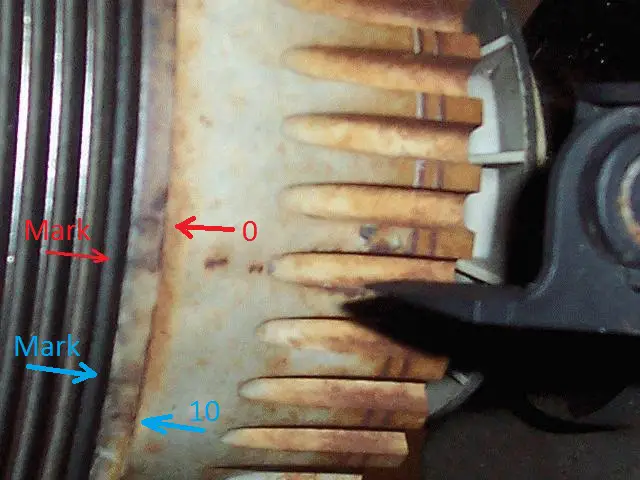

The 1st and 2nd photos don't show the timing marks good enough to confirm its correct. Refer to the photo below.
The red arrow with the word "Mark" above it should be aligned with the TDC pointer.

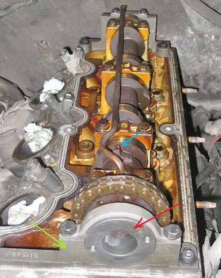

In the forth photo the camshaft sensor position "nub" appears to be in the correct position as shown below.

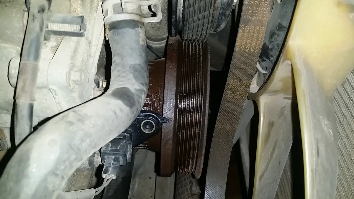

This image is better?
I can send new images.

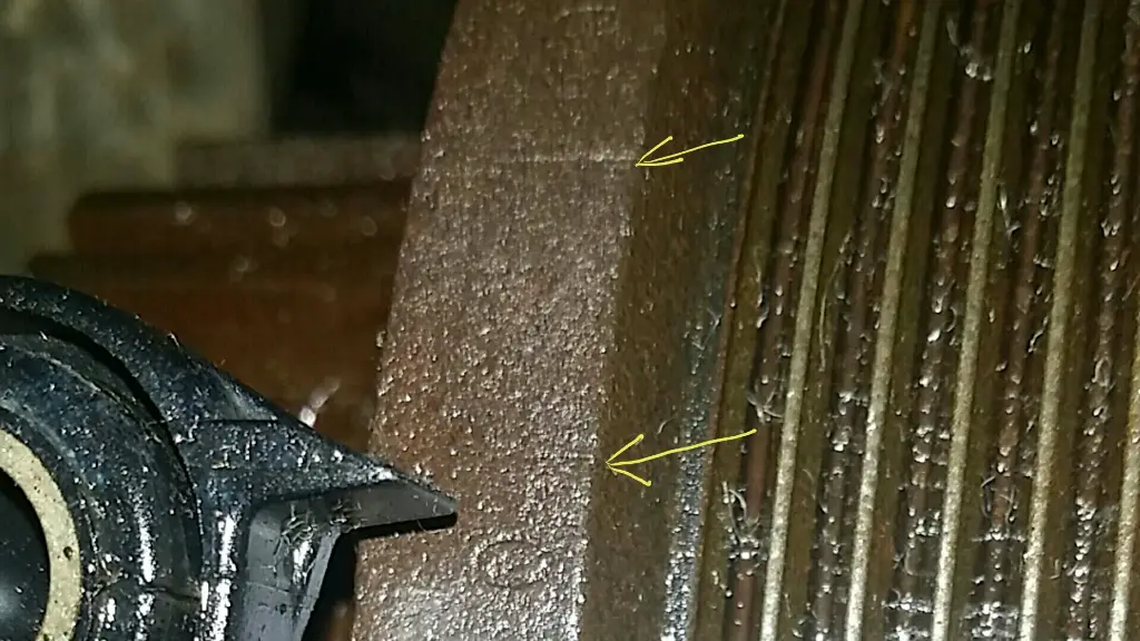

After cleaning, it was the best picture I got.

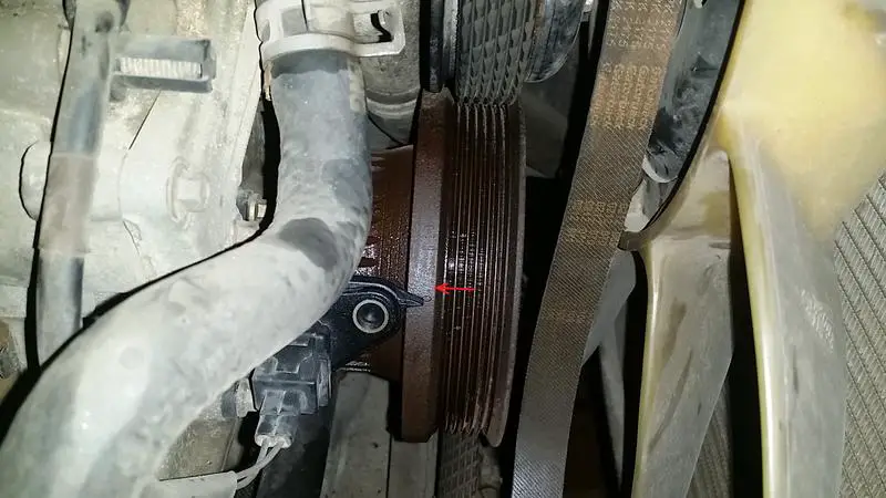

The marks are these?
I must align the point 1 to point 2?

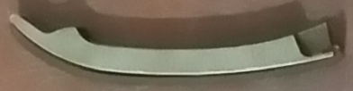

Guiderail broken.
