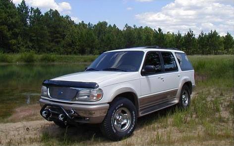

Here is mine with the 265's and a small TT (dont know if i am gonna put the bolts in Section) and no shackles or anything.
Did you like my big ass "JR"?
