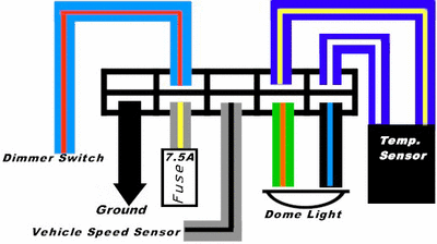

i have a 2004 ford ranger and i bought the 95-01 for explorer ohc temp and compass with the wiring harness, i need help on how to install this does anyone have a diagram or anything to help me
Do some searching, there are how tos on here on how to install it with diagrams and everything. The biggest thing with doing it on a ranger you're going to have to create the holes in the roof for the tabs on the install bracket and overhead console.
i have a original wiring wiring harness out of a 95-01 explorer is there a plug where i can plug in the power instead of having to cut the wires and splice them into different places, because i still am not for sure where to slice all 12 wires, surely there is a plug some where where i can just plug it up. PLEASE HELP
No, the Ranger harness was never intended to accept the overhead console because it was never an option. You must splice into the various wires yourself.
