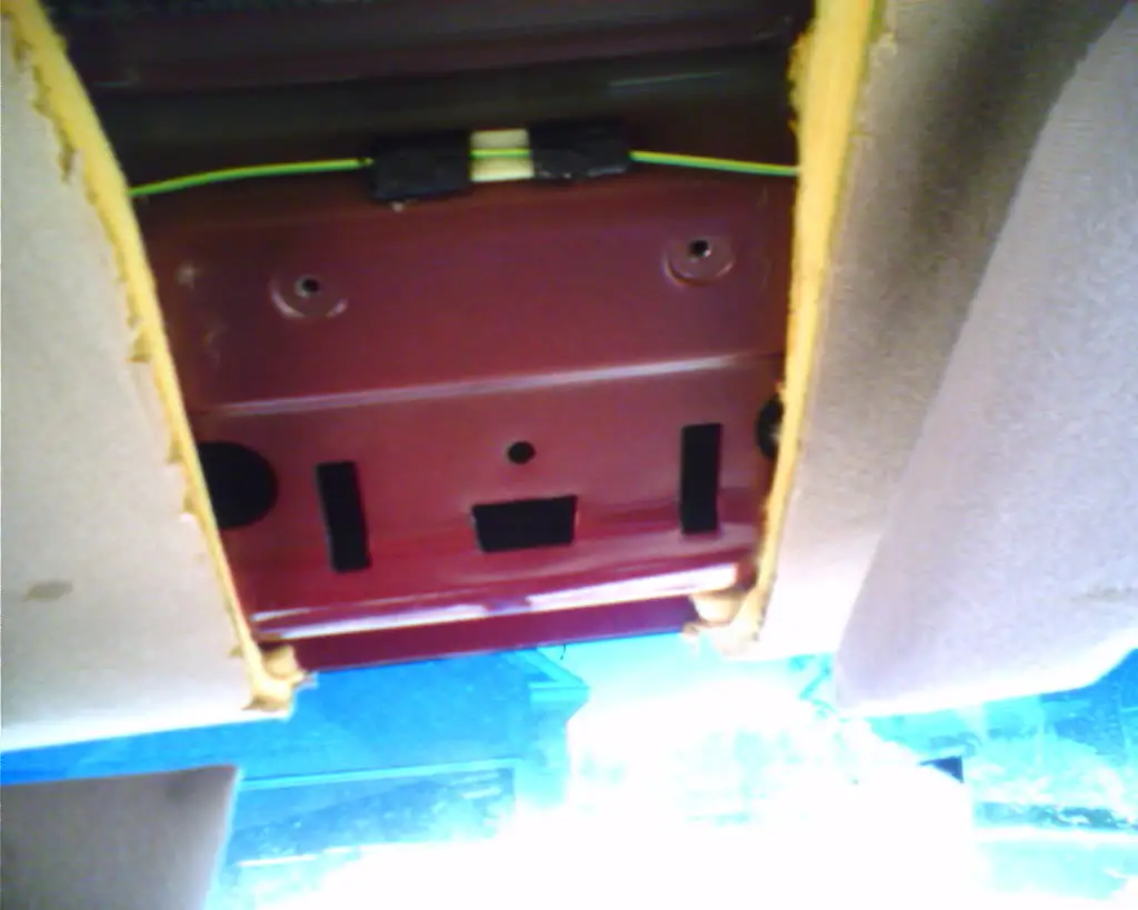

if you dont have the mounting holes, and youre ok will making them yourself itll work. i didnt have them. i just drilled the 2 screw holes and the 3 holes for the bracket to mount on.
works fine. i just did it a tiny bit to far left, but ill fix that later on. doesnt bother me since the visors still fit and shut fine

yea its these holes:
(mr q's pic)
i only did the 2 vertical slots. not the middle one or the small hole.
