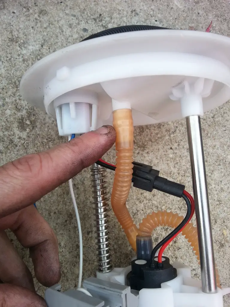

I need help. I have a 2004 explorer with the 4.0 shoc engine. Yesterday the vehicle was cranking and running just fine. Filled up the fuel tank last night to go out of town this morning. Vehicle will not crank, turns over but will not start. I can hear the fuel pump running with key on. Disconnected fuel line from fuel rail not flow. Disconnected fuel line from inlet side of fuel filter not flow. All fuses are good, relay is good inertia switch not tripped. Fuel pump is new replaced 7-16-16. Fuel filter replaced this year March or April I think. Fuel pressure per scan tool is 0.8 and should be 40 plus. I know this shows the pressure is low but new pump is running. I have spark and can crank and run the engine for a moment with brake cleaner in intake. What am I missing. Please help.
