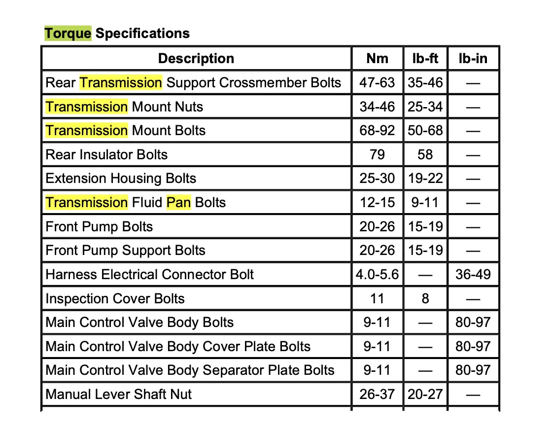

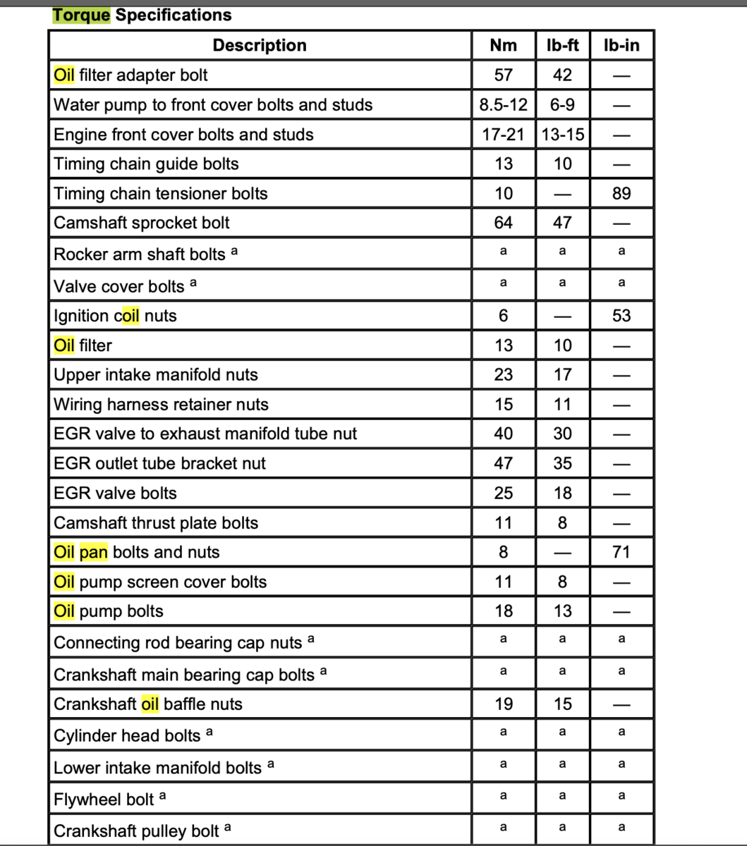

felpro and wix make good oil pan and trans pan gaskets respectively (think it was wix i used on the trans pan) i will check the torque spec after some food and report back.
Awesome. Thank you. I used a Felpro for the oil pan. It looked to be a nicely done piece. Haven't finished the transmission filter change yet. Thanks again.
this should be it
