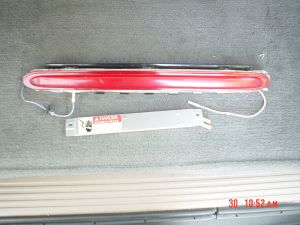

hey i have a 95x and my 3rd brake light is out. and if i were to get a new ballest or light i could be looking at 50- 300 dollars. so i was thinking and wondering if i could use just a 10 in red neon light and figure out how to splice the wire together to make that work. can anyone tell me if this will work of not or am i just wating my time.

You can't just splice into it, I tried. It has a special ballister connected to the 3rd brake light. This small ballister could be the problem and not the light itself. This is also the reason it cost $300.

thats another thing i dont no if i can just wire it from using the 3d brake light original wires. there is a balest but i dont no how man of wire are going to that or not. does anyone no.
Check with me tomorrow. I will try it. But for sure you can't just tap into the balast or the 3rd light itself. I TRIED!

I am having the same problem... Does anyone know if i went to a junkyard what do i need to take out? Where is the ballast located? And is the any way for me to tell if it is the ballast or the bulb?
And the dealer wants $300- wether its the ballast of the bulb???
williecume, I sent you a PM. This is what you need. I will send Tuesday.
