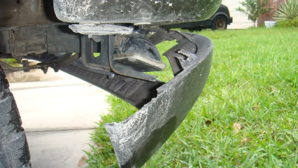

now i can tell my wife i need a new bumper.... :)

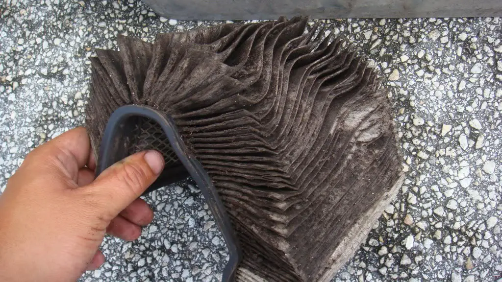

that's the old air filter
it really hit hard when it went down
