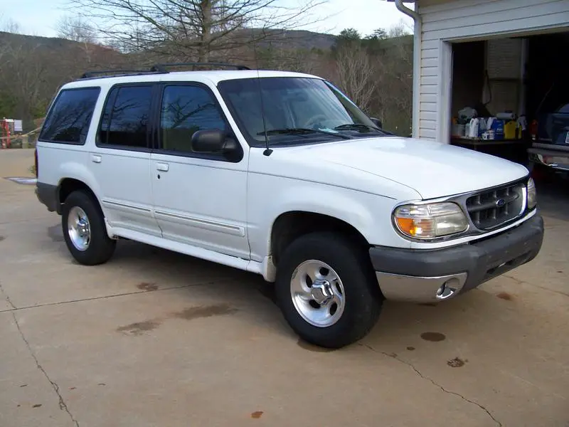

here's a picture of my baby:

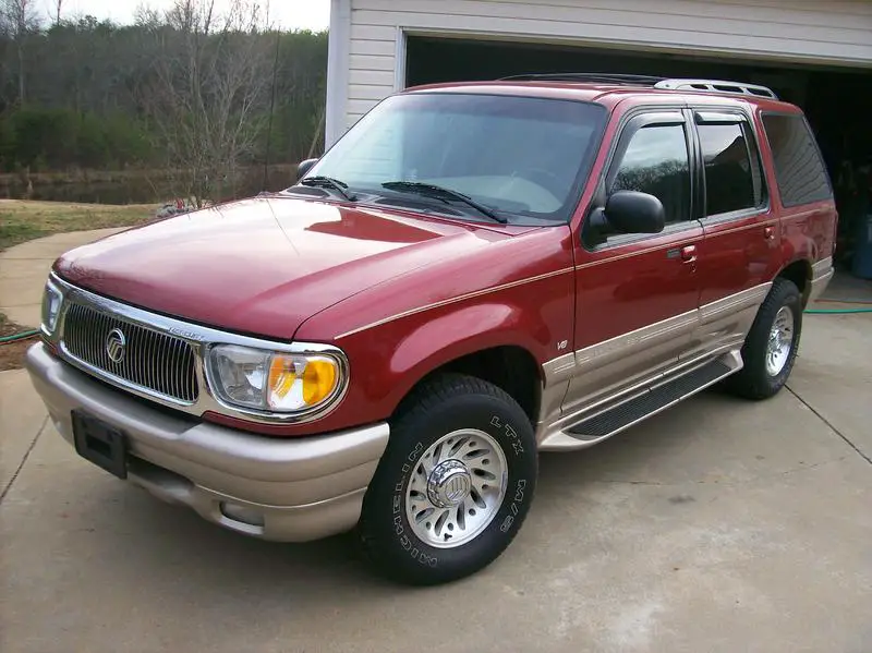

Here's mine

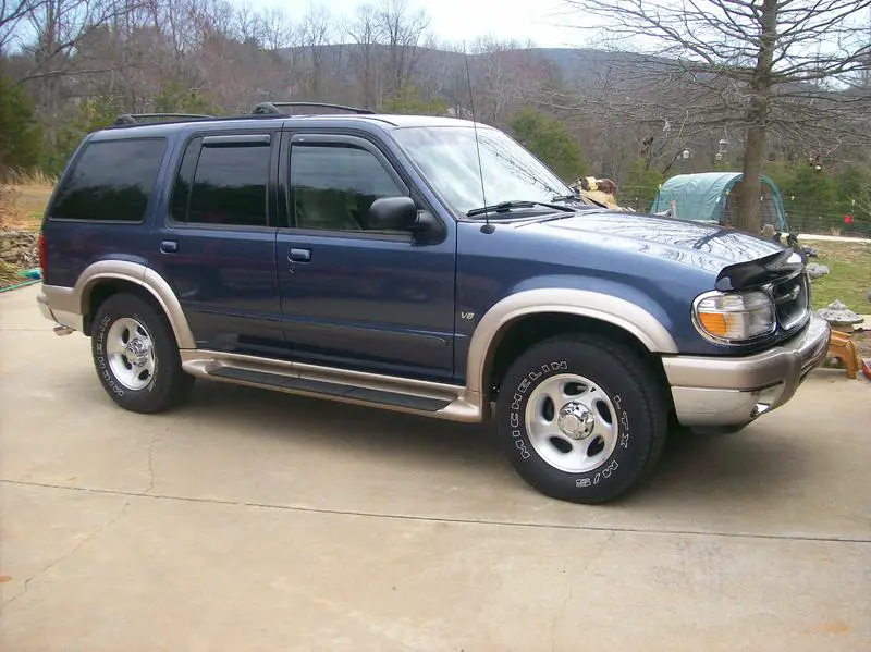

nice looking truck. worth fixing up. here's a pic of my wife's 2000 Mounty. frankly i think the Mountaineer is a better looking truck than the Explorer:
Clean ! I agree too, it's the subtle differences, like the grille and headlights. Still, the explorer you posted first is pretty damn clean too.

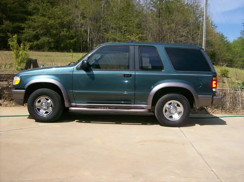

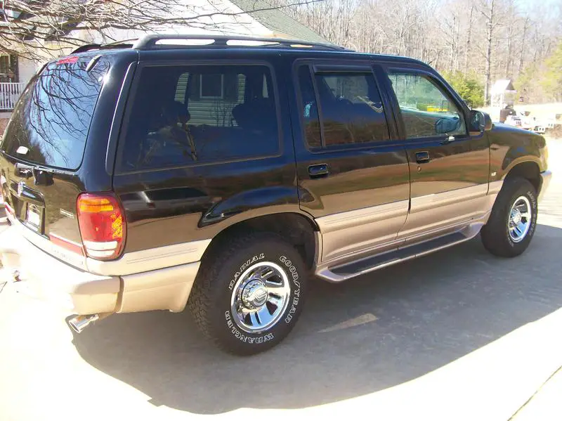

no problem:
black 2000 Mountaineer daughter 1, green 1997 Sport son-in-law, white 2001 Explorer daughter 2
Nice collection you got man. Love the mountaineers and the 2-door is cool too. Does the two door have passenger seats or is it strictly cargo?
thanks. the 2 door has rear seats too. i look for clean trucks, buy them cheap and fix whatever needs fix'in.
