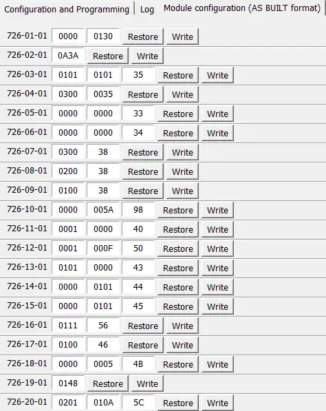

He is just changing a HEX code in the AS BUILT DATA. It's an electronic version of Bill of Materials. You send him your VIN and he pulls the factory AS BUILT DATA but modifies the HEX data to disable the feature. You get an *.AB file that is the new "bill of materials" and the dealer can upload this config file to your body control module.
The reason he has to do this is because in IDS, the address for the HEX code is not mapped so it is not listed as a changeable parameter like remote start to the technician.
This whole process is like mapping the human genome. You take two identical cars but with one thing different. Look at the as built data for both and see what is different. Take the difference and emulate it on the next car to see if now acts like the old car.
Cool thing about FORSCAN is you don't have to use a full *.AB config file if you know which HEX to modify.
Since someone says a 2012 doesn't do the double beep, we need to compare a 2012 with a 2013s As Built Data (must be pretty damn close in features). See what the difference is and that should narrow it down.
Once this area of the config file is figured out I can send the info to the Forscan team and they can add it to Program so all you have to do is go into the non-AS Built Data programming for body control module and either select enable or disable.

You got Forscan? Can you read your Body control module and post the hex values (AS BUILT DATA)? Since you got a 2011 can you confirm if you have ever had the double honk when leaving the car while running?
Looks like this (but goes down to like 726-68-1):
