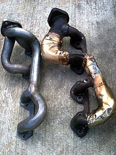

I think they may have re nembered the headers.... If you look at the pic on summit of the P50s they look like regular shorty headers, not the explorer specific shaped headers like the ones for the 96 Explorers. Also, the P50s in the description are 1 5/8 diameter while the headers listed for the 96 explorer are only 1 1/2 diameter. I think Ford may have screwed with the numbers when they reintroduced these.
here's the pic from summit of the P50s
Here are the GT40 headers listed for the 96 Explorer next to the factory 'headers'
They don't look like they will interchange, especially considering the tight clearances on an X. It would be really nice if they work though cause the Headers for the Explorer look really restrictive.

I would really like to know which headers to get. I will be replacing mine soon on my 97 to get rid of that damn ticking noise from the stock stuff. From the picture above the P50s look like they will need a custom exhaust after the header. I guess this isn't a big deal for me since I was planning that anyways. Let me know if you guys needed anything custom with those headers.
