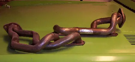

ok, so let me get this straight. If i have a 1996 Explorer, do i need the goofy ass looking headers?
Well the two headers would have looked exactly the same.. just the Ps would have the bung on them. But yeah, you would need the standard headers for the GT40s. So, no. Not the goofy looking ones. :D
you need a set of these, and good luck finding them. just so happens i have a set new in box muhahahaha.
