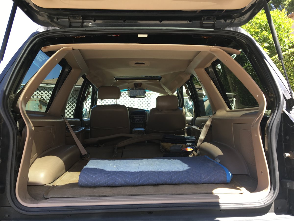

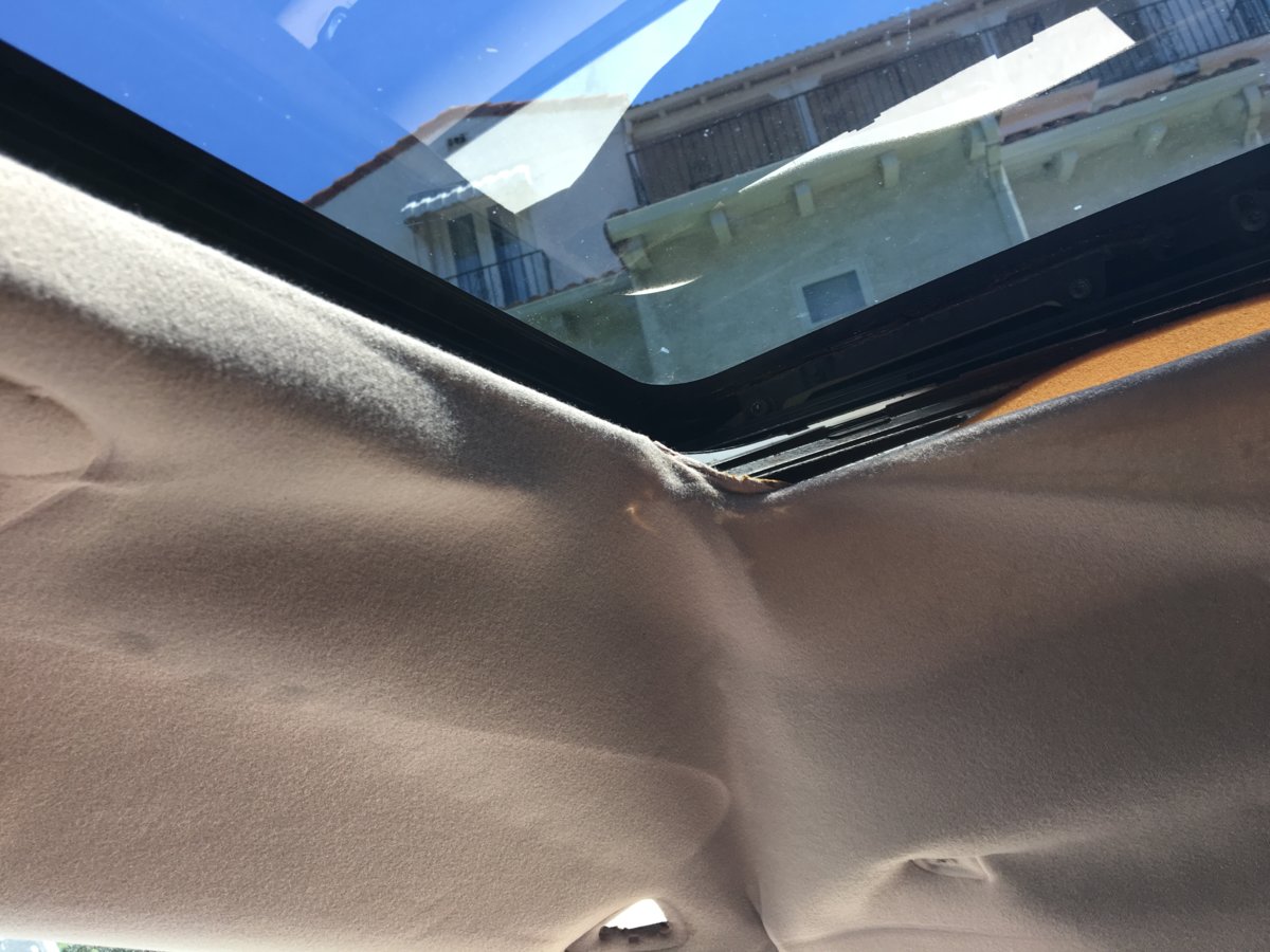

Here are the the problems & photos:
1) I noticed water spots on the headliner & could see the moonroof glass was not sealing properly.
2) Right side of glass is substantially detached & unglued from bracket plate.
3) Arrow buttons work intermittently, C sometimes works, buttons 1 & 2 stopped working.
4) Headliner is completely detached from ceiling EXCEPT for the front & back edges of the sunroof cutout. I cannot figure out how to detach the retaining clips without tearing the fabric.
5) I still do not know where the sunroof motor is physically located on this model (above which seating position, for example).
6) To clean & reglue the right side glass to the track bracket, it probably needs to be removed & that brings me right back to the headliner removal problem (#4 above). Please see photos; any advice will be greatly appreciated, thank you!

I’m sure the leak came first. 3 star-bit bolts on each side secured the glass & brackets to the track & I was able to remove them & take the glass & frame out of the vehicle. Most of the glue under 3 sides has failed (not just the right side). I’m in the process of regluing the glass now & will install tomorrow (see pic). The driver’s side track arm was very stiff & could have put additional stress on the motor. I’ve cleaned & greased both arms & they now swing freely. My plan is install the repaired glass tomorrow & just try it again with my fingers crossed. The entire headliner is disconnected from the ceiling except for the front & back edges of the sunroof cutout. If I get lucky & the power & switches work, I’ll put everything back together & callit a day. If it doesn’t, I’ll probably take it to a sunroof shop & pay them to finish removing the headliner from the sunroof cutout.
