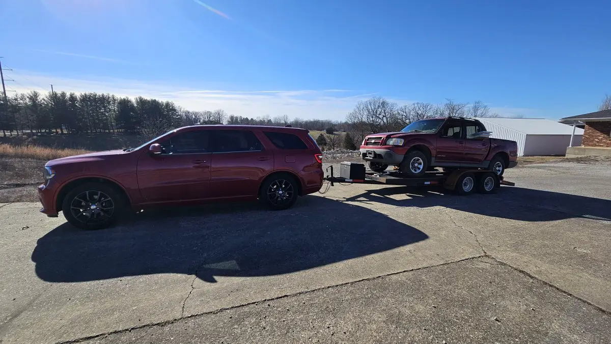

Anyway, here it is behind the most surprising tow vehicle I've owned:
Welcome to the site. Sounds like a sweet project. Good color choice too.
