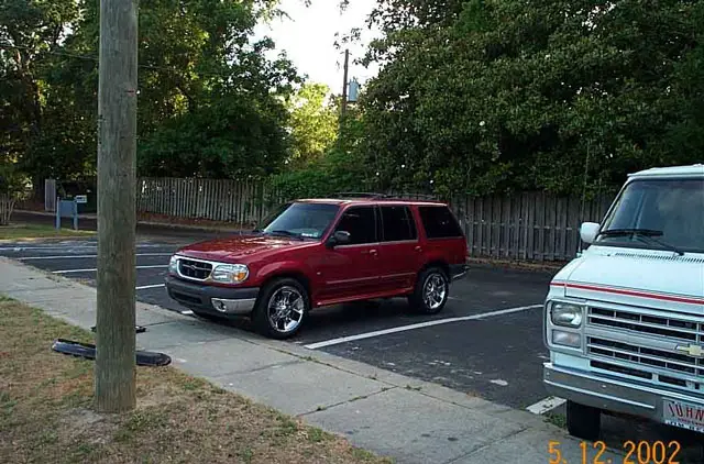

follow to a "T" what jssong said that is what i did. just take a look at mine here. the only place they rubbed was a teeeeeny little bit on the rear where there is a little plastic piece sticking out but i took a sawzall to that and it is no longer a problem.
