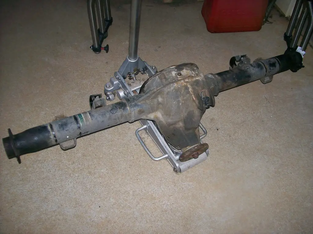

The offending rear diff is out. Just like pulling a bad tooth...

Used rear '01 ST diff ETA tomorrow according to shipper. Here's hoping it's the right one and in better shape than my old one. Fingers crossed. Other than some cleaning, I've been in a holding pattern. I did find a nice OE ST bed mat on eBay last weekend and picked it up for cheap. It hides the spills in the bed and makes it more useable, but I've discovered that paint stripper get's the mastic off pretty well w/out harming the plastic. It's a slow process though.
Just picked up my new-used rear diff. It looks like the right one. I need to scrape the grease off it and take it apart to see how the gears look. While I'm at it I'll replace the axle seals. It's supposed to be a 4:10, but all the tags are missing so who knows until I count the teeth. They pulled the brakes and backing plates off (which is fine as I want to reuse mine) and they pull the rear cover to drain the fluid out for shipping, so I'm guessing that's where the tags went. I wouldn't hate it if it's a 3:73, but then I'd have to reprogram the PCM for the speedo to read correctly. I'm just praying this is a good unit.

In the cold, clear light of day, I think the damage to the axle tube on the replacement diff is severe. I probably would not be able to install a seal and not have it leak. To remove the axle to get a better look, I also discovered that whoever removed the brake backing plates before shipping also stripped the head of the 8MM bolt that holds the pin in. Without removing the 8MM bolt the axles can not be removed. Due to the location of the bolt no tool (other than an 8mm box wrench or socket) can be used to remove the bolt. I'm not willing to spend much time on this as the axle tube damage probably can't be repaired. I just sent the seller an email with photos requesting an immediate replacement or a refund. Crap!

Yeah, this sucks. I'm trying to deal with the parts sourcing company that I bought the diff from. So far they've emailed me instructions on how to return the diff for a refund, but it says "the customer is responsible for return shipping costs". That would be fine if I had just decided I didn't want the part, but I'm returning it because it's damaged and unusable. A quote on return shipping was $278, so there's no way I'm going to pay that! I'm waiting for a supervisor to call me back. I also called my credit card company to ask how I can dispute the charge.
In the meantime, I crawled under my 2000 XLT 5.0 to look at a Gen II Explorer diff with disc brakes. The diff looks identical to the '01 ST drum brake diff, just extra parts bolted on that are specific to the disc brake setup. So I'm thinking that I could just buy a used non-ST diff and swap over my drum brakes. I've found several Explorer rear diffs on CL for around $150. They're 3:73's but they are posi, so that may be the way to go. I just need to verify that the axles are the same length. I'll check RockAuto for that.
Update: RA shows the axles are the same.
Well, after 6 calls to the parts sourcing company, I finally got to speak to a supervisor. He approved my return and said that they would refund 100% my purchase price, but insisted that I had to pay the nearly $300 return shipping cost and that amount would not be refunded. He reasoned that they had to pay the shipping to sent it to me, so it was only fair that I had to pay for the return shipping. I told him that was a load of crap and that while the damage was not their fault, that's the cost of them doing business. Then I called my credit card company and they said that they would refund my money w/in 48 hours, that they would not charge me any interest and that they would get the seller to issue a shipping label, saying that if you purchase something and it arrives damaged, the return shipping is on the seller. So while I'll have to go through the hassle of getting the diff ready for return and bringing it somewhere the truck can pick it up (no 40 foot tractor trailer can get up my driveway) at least I'm not getting screwed out of $300.
My advice - NEVER BUY ANY USED PARTS FROM QUALITY AUTO PARTS! Quality... that's a joke.
Now I have to ressume my hunt (locally) for a used diff, but at least I've figured out I can use a diff out of any Gen II Explorer or Mountaineer and just swap the brake parts.
