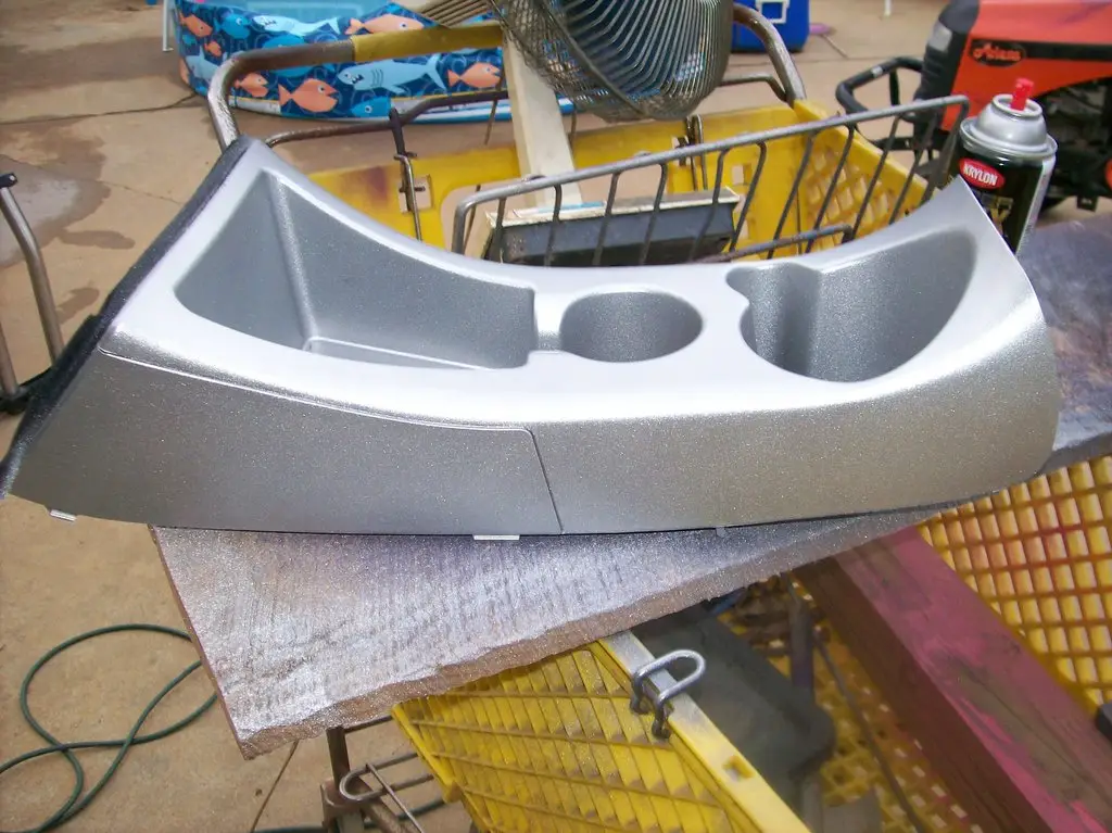

Decided to start painting some interior parts, starting with the worn center console. Quite a transformation, no?
After cleaning. Dull scratched and ugly.
After a couple of coats of paint.
After the final coat. It has a nice texture to it too. Tomorrow the radio bezel.
That looks outstanding! Most excellent job on that console. :biggthump
