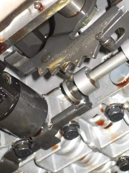

You don't have to get a new gasket if the old one isn't ripped or compressed out of shape. Use a 1/4" drive In/LB torque wrench on the valve body bolts. Make sure that each bolt is the correct length for the hole, and tighten them in a criss-cross fashion.
Gear successfully replaced :) .. One last question ..is there a certain procedure for reinstalling the neutral safety switch?
The best way to ensure that it will be correctly aligned is to mark the case & DTRS prior to removal. There should be a notch or a line on it to line up with the case. By the way, how did you end up removing the roll pin?
