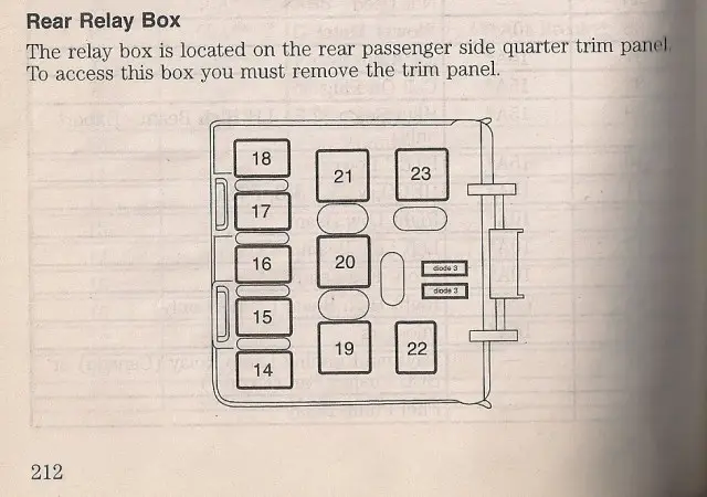

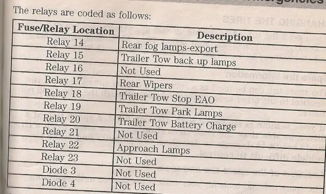

Here is the info from my owner's manual, which is the second printing. I have an early model '02 XLT, and I see you are in the Great White North, so I don't know if this info will match your vehicle. If you need an owner's manual Dead Link Removed.

The Auxiliary Relay Box & The Rear Relay Box also contain items related to towing.
The Auxiliary Relay Box is located under the hood on the passenger side, toward the firewall, under the cruise control module:
The Rear Relay Box is located behind the rear passenger side quarter trim panel. The panel must be removed to gain access.
