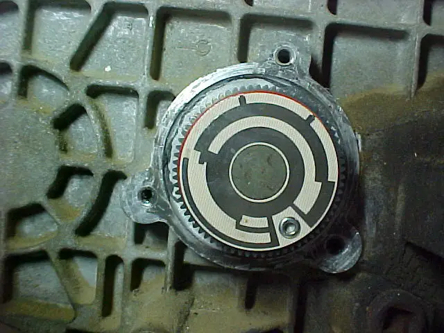

The 4x4 dash and button lights only come on when the T-Case geared selector has correctly shifted into 4x4.. Basically there are some wire fingers attached to the cover of the geared position sensor as seen below. When the shift motor is rotating the the fingers on the cover make contact with the metal strips on the sensor.. Only when it its the metal strip that coincides with 4x4 will the 4x4 light come on. The same for 4x4Low..
Geared position Sensor
Cover
