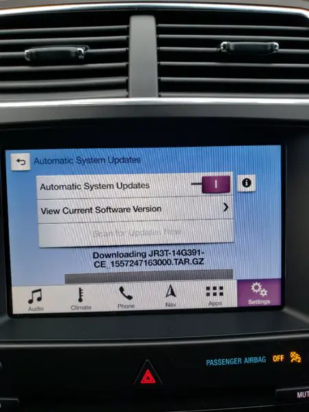

On the software update - I thought perhaps I needed to reset and start from ground zero.. Reset to factory settings and proceeded to connect to the internet for getting the latest software upgrade.
Upon start of the software update journey the system detected there was an upgrade available. Started the download and it seemed to be hung... I searched the internet and found it could take up to 30 minutes to download. Ok, I left it running... Still the progress bar seemed as if there was no activity. Then the engine turned off.. ok, read online this could happen and I should turn the auto engine shutdown off..

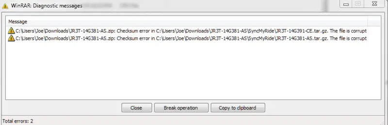

After creation of a *new* email account I proceeded to download the software update.. Upon completion of the download the unzip operation reported files were corrupt... A seconded attempt yielded the same results...

This is the error I receive if I use an unzip utility...

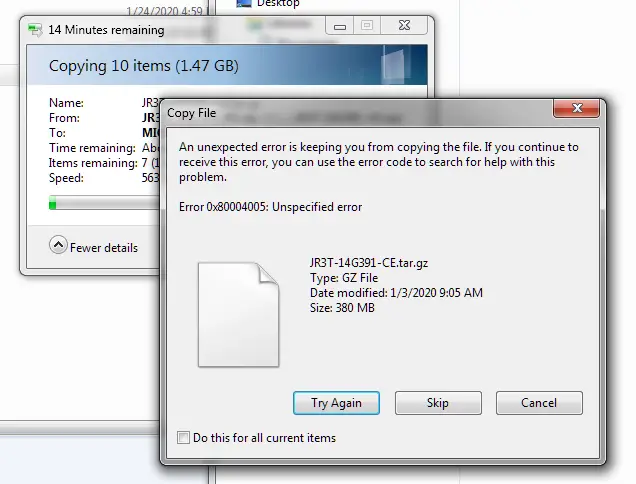

Went back and read install instructions... states one is to open using Windows Explorer and drag files to USB device.. Did that and still having an issue..

Now doing a full format of the USB device (exFAT)..
Hey Peter... the following is a pic of the display during the attempt to download the software upgrade file via WIFI..

ok, I give.. after a fresh full format of the USB device I'm still getting an error.. Going to call in for a service appointment.

I believe another member had the same notice that it was downloading but it never did. As I mentioned before, I've never used an Unzip Utility program. I just dragged the files to the USB drive and inserted it into the Explorer USB port.
