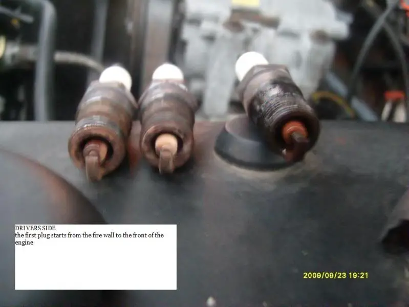

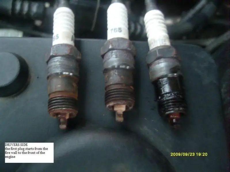

i didnt have time to do a compression test i started to do it but had a hard time screwing in the tester on the passenger side back spark plug so i decided to pull the plugs out and to see how there like i just put these in 6k miles ago looks like they need to be replaced that one oily spark plug puzzles me. heres the pics
If you lucky, that may just be the lower intake leaking..
If your unlucky, thats head problems, or possible ring problem.. But ring problems wouldn't make it smoke like your vid.
Once you get your compression #'s we will have more info to give better ideas..
If you find that #4 cylinder (drivers side front) is lower compression than the others, put a "little" oil in there, and do the compression test again.. and see if the #'s change.. Actually, do that on any cylinder that reads different than the others.
Also, the smoke in the video to me looks white, not blue. .which is water not oil.. or at least mostly water.
~Mark
what does oil on that plug mean?
Just that oil and or water is getting into the combustion chamber. the next question is to figure out how.. You'll need to do the compression test before you will have a better idea.

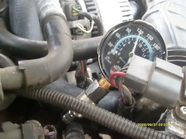

ok so i did my compression test... i couldnt do the back passenger side plug was hard to get the hose for the compression tester in there.
rear drivers side
middle drivers side
front drivers side
passenger middle plug
front pass side
Thats good news...
It "sounds" more like intake manifold now and less like head. Head is still "possible", but less likely..
~Mark
should i get that last cyl on the passemger side tested? thats where my last issue was. what about the oil on that plug on the drivers side? also oil was comming out of that plug hole when i was doing the compression test. not pouring but splattering alittle
