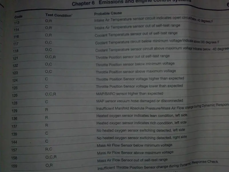

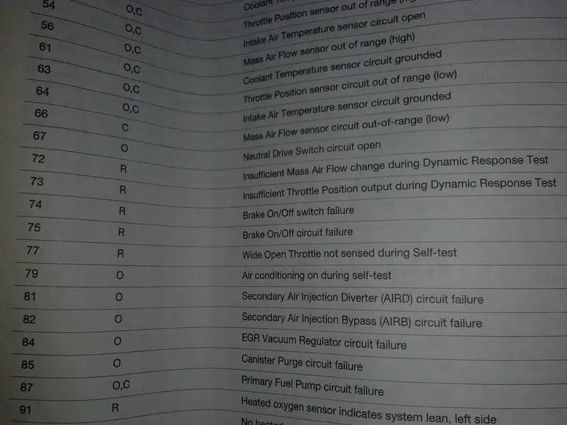

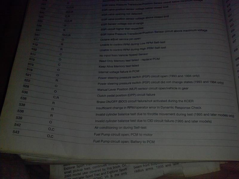

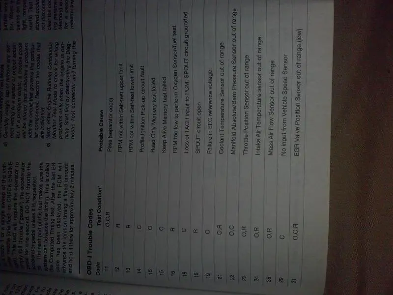

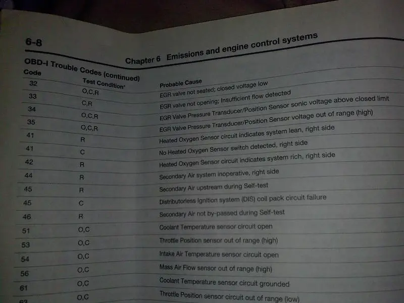

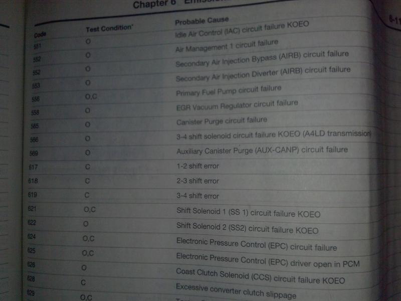

Decided to take a picture of the trouble codes these are straight from the chilton book

The Chilton books were pretty bad on... a lot of things. Oldfuelinjection.com (formerly FordFuelInjection) is a better resource and has a ton of information on the Ford EEC systems, including all codes.
http://oldfuelinjection.com/
Well i was doing this for the people saying whats this code now all they have to do is look
