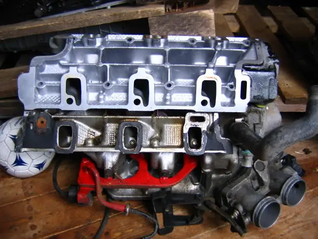

Do you have pictures of your 2.9 engine in the car?

Do you pictures of your new 4.0L?

This music to my ears.. The 2.9 is the car type with twin MAF and twin input to the throttle body
It isn't the 24v cosworth but the bog standard EFI bosch L-jetronic injected (knocks out about 170bhp) with distributor ignition. Uses very few sensors from what I can see.. maf,coolant/fuel/air temp, throttle position. Trans is rwd Ford MT75. There are no CATs so no o2 sensors although I can retrofit these if they are really needed...

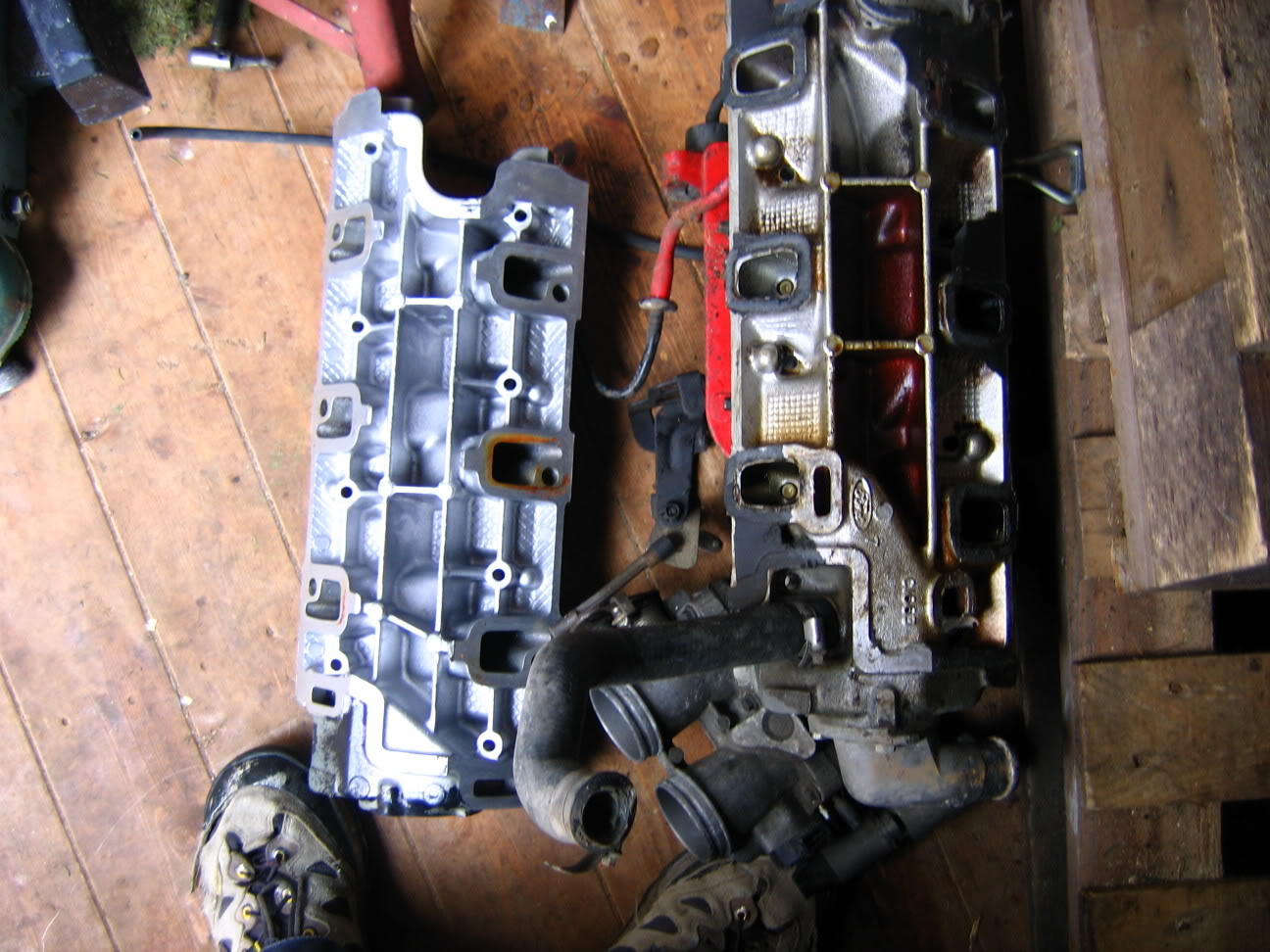

The new engine is definately '97 (engine no. 95MT6090AD, Heads: 97TM6015AA with U above exhaust manifold) here is a pic of it with the intake manifold and injectors off and one of the TVR manifolds offered up to it for fit - they sweep forward then under the car for extra 'acoustics'
When you say use the intakes from the 2.9 are we talking the inlet manifold and plenum? The Unichip I've got was 'mapped' on a rolling road to my engine and the tuner seemed to have the ability to move the power and torque curves around a bit so I guess that will help to give me a little more buzz and push the peak power up the range a bit.

the intakes pictured on your 2.9L are the same that we had here in the states in teh Merkur scorpio car. I was not aware they had a mass air flow sensor and I dont see one mounted to the airbox in your pictures? Are you sure its MAS? 2.9L's in the Ranger had MAS here in the US after 1990, especially if the truck was a California sold vehicle.

Can we see a picture of the underside of your upper intake manifold?
I am curious if the lower intake is similar to the Ranger style 2.9L.

The Merkur ('Sierra' over here) intake manifold would fit except the cooling system has changed slightly. The newer engine uses an extra bit of casting with slots for coolant whereas the old manifold uses a pipe arrangement. Interesting to see the differences though, the port looks more 'open' in the car manifold and the injector is sited inside the port whereas the truck one is sited next to the port, the port in the truck is also a lot more 'direct' with less of a bend in it and seems slightly shallower;
