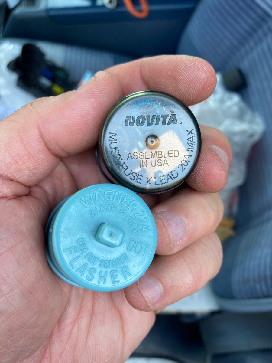

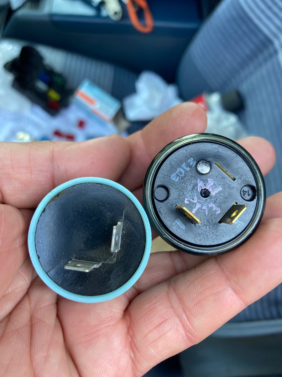

Wanted to swap out the signal flasher relay and ordered one online but what came was a slightly longer replacement and I’m looking for a same size replacement so I can close fuse panel cover. Picture attached. The blue Wagner is the original one.
An electronic flasher should be smaller.
Yes. I’m aware that the replacement is larger and wanting to know which replacement you guys have used in past. I see someone mentioned bussmann 552
solid state flashers can be me much smaller. Sniperdyer purchased the em type relay. I assume the original wagner is a bimetal/thermal type (which the bussmann 552 is).
Thanks. Just ordered one. I’ll measure when it comes in
