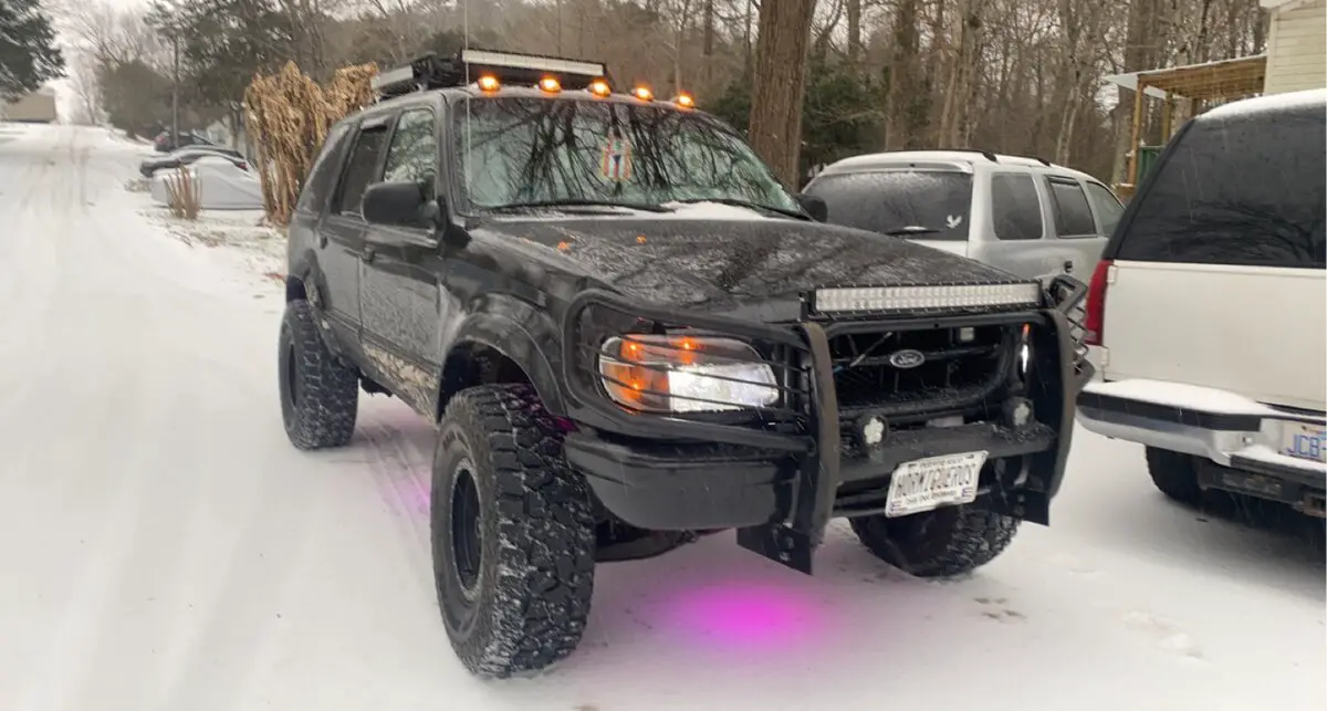

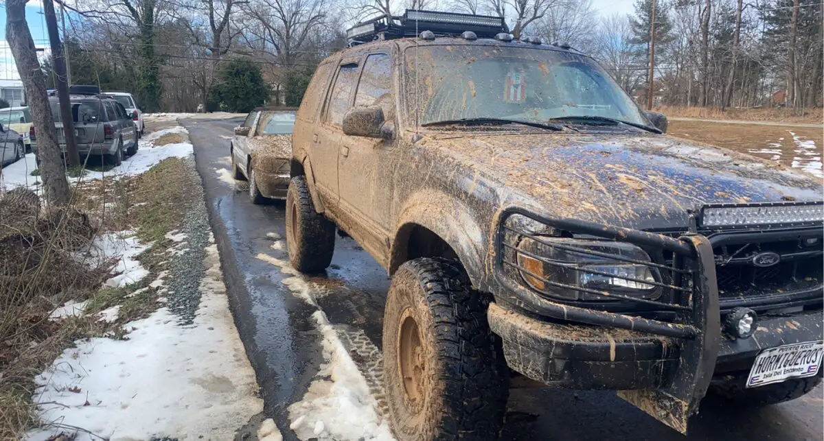

Hey guys I have a 99 ohv with the 5 speed manual trans.I’ve recently put my lift and new wheels and tires on (33x12.50.15) and noticed instantly that my 1st gear feels almost like my stock second gear and my 5th gear has no power Whats so ever so I know that I need to re gear it I was wondering what would be a good gear ratio?where is a good place to get them from?and how do I check what gear are in it now and how to figure out what front and rear end do I have.any help would be greatly appreciated

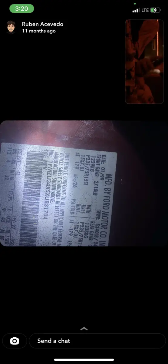

This is the only photo I have of my original door before I changed my doors out.is there any Info there for the axles?

I do a pretty good amount of highway speed.I’m back and forth from pa all the time and on my door sticker it sais 45.I don’t really know what that mean if you could help
45 is 3.55 open. You have a 35 spline Ford 8.8 in the rear and a IFS D35 up front.
