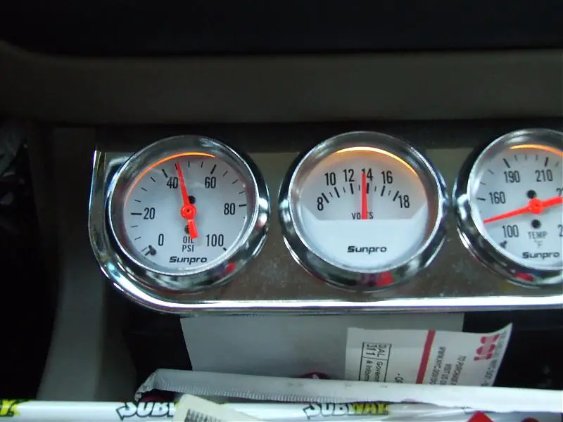

I think you should definitely setup your guage inside your truck.

Is there any good spots to mount a gauge in our trucks without having to take the dash apart or anything?

I didn't remove my dash. i have mine on the center console. Only thing I did with my mechanical guage was buy copper line instead of the plastic one. You can buy a pilliar mount and put the guage there. or they have on dash guage pods.

How did you route the lines for the gauges, keep in mine I only have a 93 so it might be different from yours.
No I bought it from Harbor Freight and its listed as an oil pressure gauge
bingo found your problem. its harbor freight...junkkkk
So maybe I need to invest in a good quality gauge here.
I don't think there stuff is junk Gauge technology is so old, its no new science to make them. They probably get there gauges like the next guy....lol.....lol guess I won't be buying any guages from them.
I just didn't route the raw line. I bought some tubing from PepBoys and covered the whole length of the copper with it(tried to feed it through, but was easier to slice tubing down its length). I got it from the vacuum lines and heater hose area. I drilled a hole in the firewall (right side)to route the line. Then along under the dash where your feet go (under the heater core) into the center console. Just keep your bends big. I have a bypass filter sitting just in front of my firewall on the right side. I am getting my pressure after it goes through 2 full flows. So its pressure that is actually going to the engine,not before the filters. I fed my guage from there, thats why i drilled right under my heater core side. the outside diameter of the rubber line was 3/8. I just started with a small drill bit and 2 sizes later had 3/8 hole. I don't have one of those step bits. It was very easy. The firewall is thin. Just don't push through and hit a vacuum hose or wires on the other side. Go slow be careful of whats on the other side. Put a t-fitting in your sender port now and feed the guage and your stock guage. What side is your sender port on?
the electric guage is cheap from tradervar. Buy that one and route the wire...and save a big line hassle.
An electric gauge seems like less of a hassle to me, but will it give me a good reliable reading like a mechanical one will?
it should be fine. I see no reason not to go with it. I bought mine for cheap as a set so went with the mechanical.
my next set of gauges , trans oil pressure and temp will be electrical.
Sounds like Ill be going electric then. Ive just got to find a way to route the wire for the gauge
you can put the wire through the weather boot around the steering column. That is where my fog light wires go. get some small diameter tubing and put the wire in that so it will be more protected.
Thanks for confirming, I was thinking about the grommet at the steering as well.
Thanks again, you guys have been a great help.
