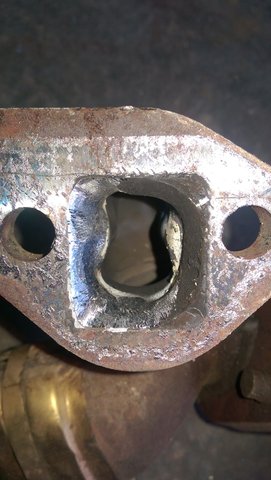

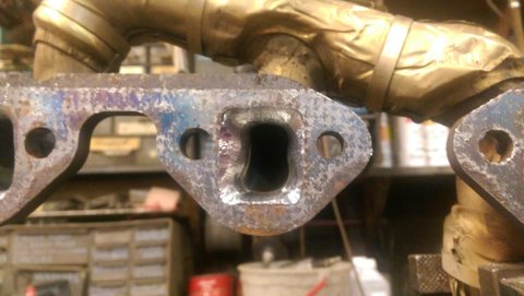

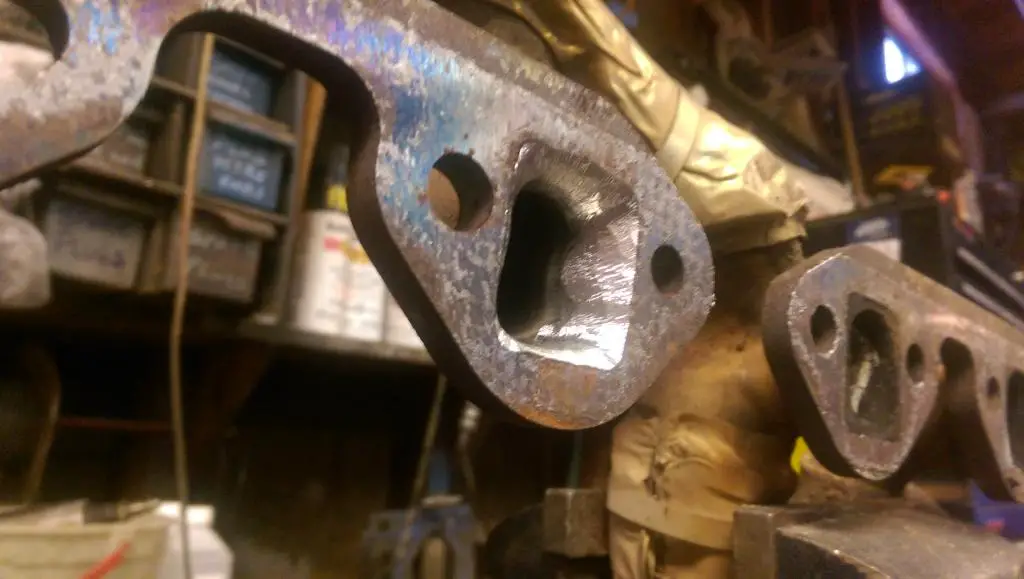

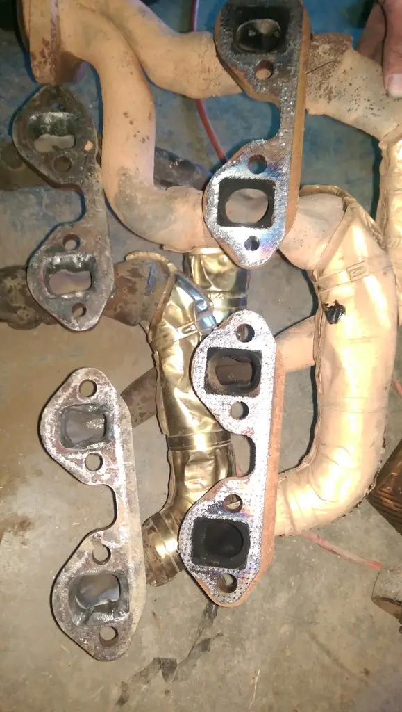

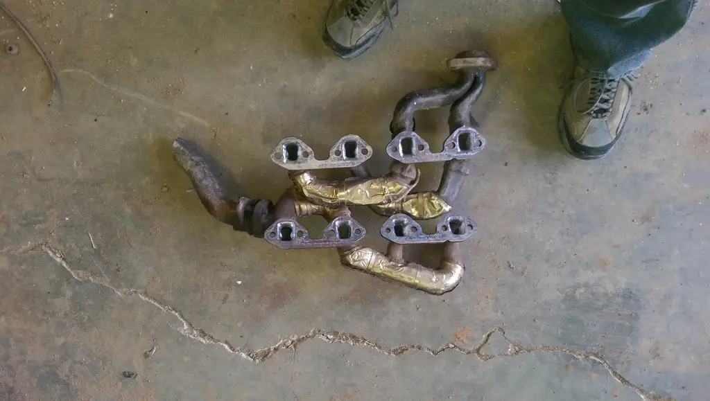

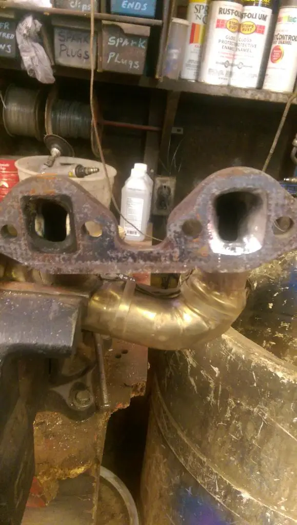

So has anyone dared to try this? Was my Q and not that I could find so here I go I am in the process of modifying and opening up the factory headers/ manifolds for my explorer, I will post some pics latter today.

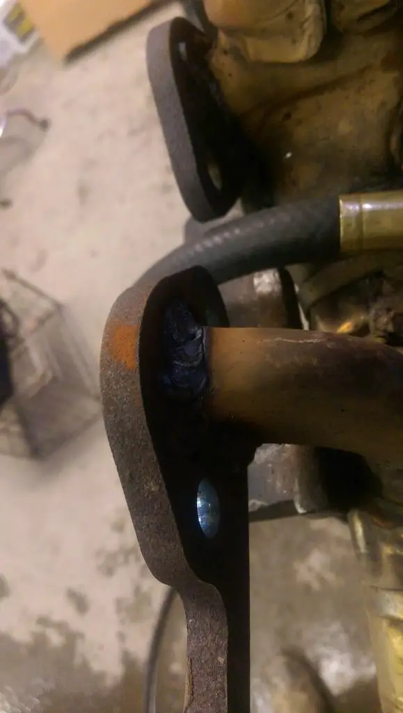

So what I did was weld the tubes to the flanges on the out side to add stringth and used a carbide bit to remove matereal from the inside. This is what I have done so far. There still closed off a bit but are open twice as much as they were and I gasket machete it and smoothing it out so there's no ruff edges, this may not do much for performance but they should flowe a bit better.

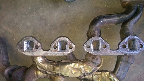

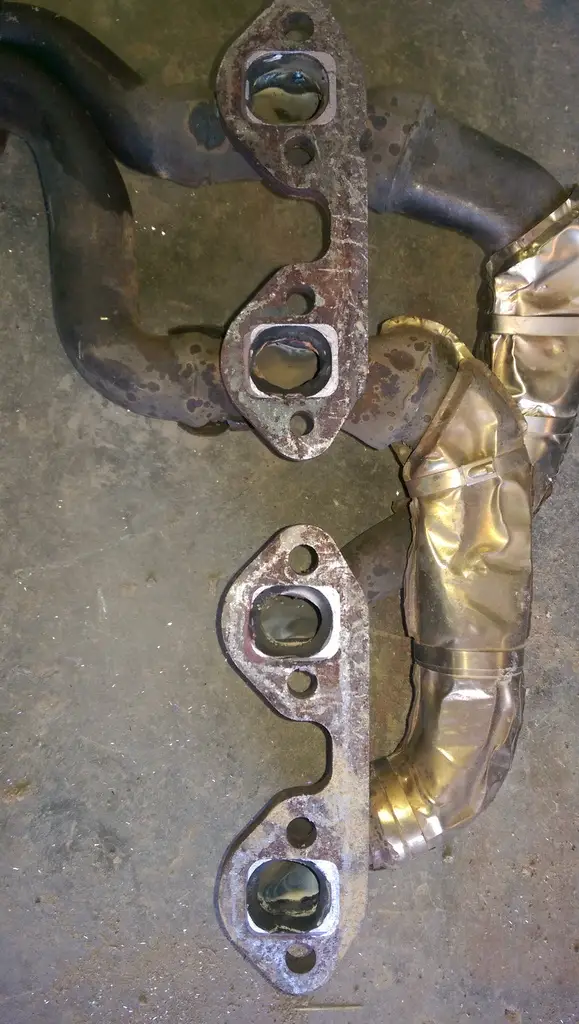

Ok so here's more pics, I finally finished it today and can say you can feel a difference.

OK here we go.
Most are of when I was still cleaning them up, I did notice a difference in power and a touch in mpg. It also fixed the ticking sound you get with the factory manifolds.
Ah I see. I was thinking you were able to open up all the crushed tubes. It's amazing how just porting was able to make a noticeable difference.
I was going to try to do the tubes but then the bolts won't go in.
I think that's why aftermarket headers needs studs.
