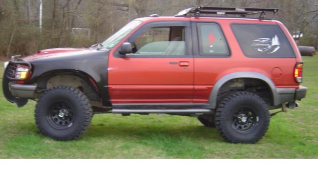

with the 4" suspension lift and NO TT you're gonna sit slightly higher than me in this pic... and you'll have 32s. If you do the TT with the SOA in rear you're gonna be up another 1-2 inches on me which may even look wierd on 33's.. i can fit 35's now if i wanted...
Just to give you an idea cause thats a lot of money to spend:

Damn it Matt! Is Perry's paying you commission on these things?!
