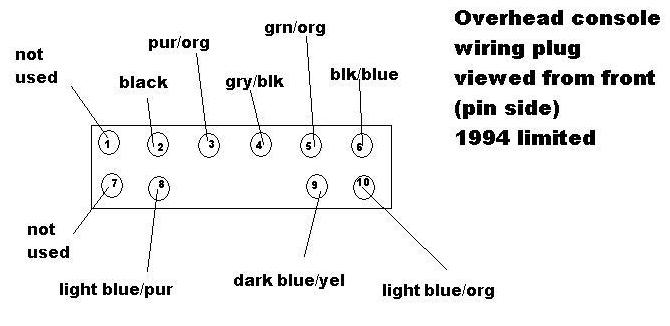

hey, to anyone that has installed one of these. i pulled the wiring out of a 94 limited, and tried using the installation guide on explorer4x4, but some of my wire colors dont match up. for those of you that have 95+ wiring, can you tell me which pin (numbered) is which wire? so i can hooked this up right. thanks!

Nevermind about the above post, i got it working now. but now i have a question. my temp was reading fine when i left the house this morning, but when i came to work, it was reading "5C". the sensor is brand new, as per ford dealership. what could it be?
on a side note. the plug for the sensor, i already had installed in my 92. it was part of the wiring harness, from the factory. i thought the consoles didnt start appearing in 93? but i had one, plugged in the new sensor, ran my two wires, and it worked (up until now) thanks yall!
