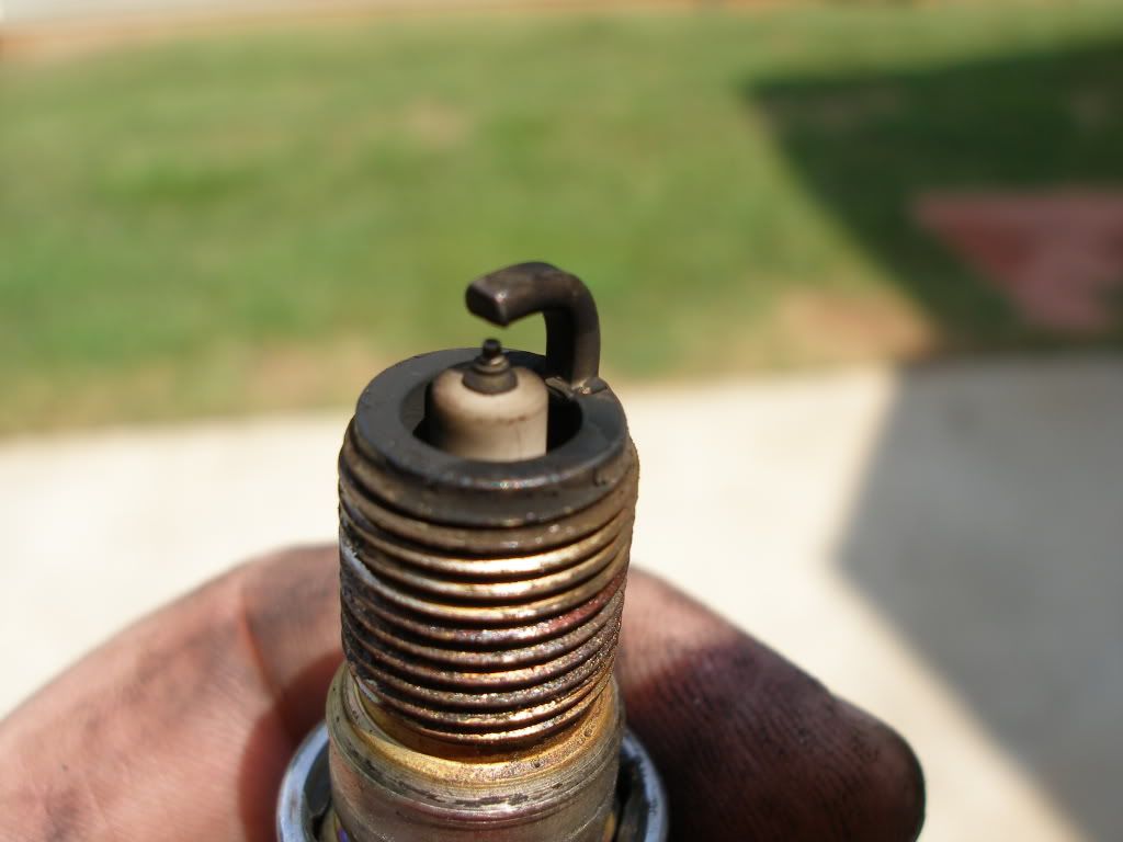

P0171+terrible gas milleage=?? **UPDATE WITH PICS***
'99 OHV
Ok, I have p0171 code ONLY, not p0174. I have terrible gas milleage and odd stutter when barely pushing gas pedal at certain speeds.

Did you check for a vacuum leak on bank 1?
Did you check your Fuel Pressure ?
Did you read your plugs to see if it is one specific cylinder that is lean?
I would start with those and then move on.

The point here is that, since there are not O2 sensors for each cyl., one cyl. running lean (due to clogged injector) will be interpreted by O2 sensor as overall not enough fuel being delivered, so fuel delivery may be increased, causing actually too much. imp
Exactly, it thinks its lean so it adds more fuel and is actually burning rich. Clean the MAF and check the PCV and air filter. If all looks good I would replace the O2 sensors. Thats a lot of miles on original sensors.
