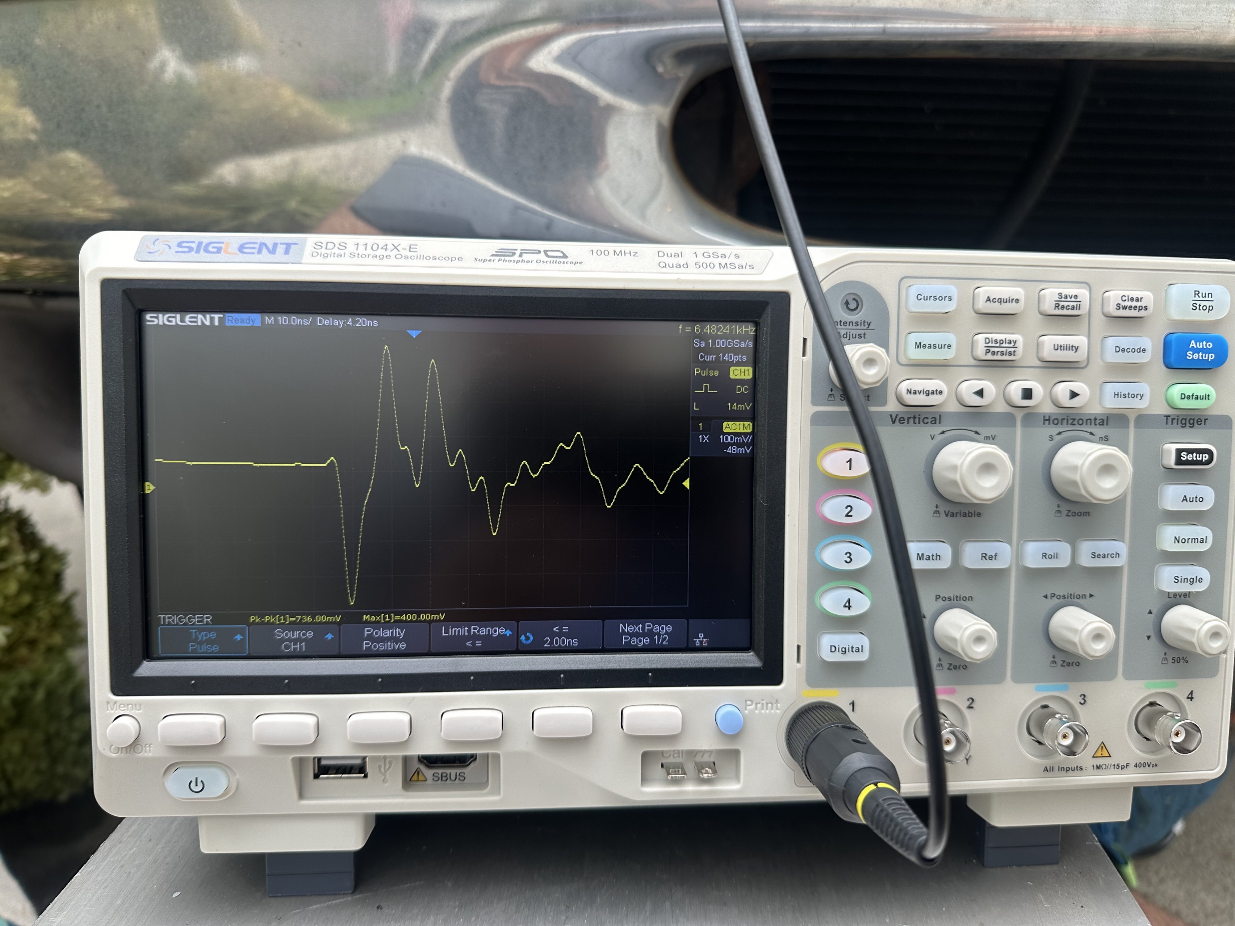

So I haven’t used an oscilloscope since college physics, but I was able to get a semblance of a waveform out of the alternator. It would look acceptable, then this nasty would come out of nowhere. Seeing peak AC voltages in the ~500mV range (1.0VAC peak to peak), and it is just all over the place.

I installed a new Bosch alternator. I compared diode tests between the new and the old. The new alternator had about 33% less forward bias voltage drop through the diodes compared to the old. Whether that is of significance, I don’t know.
The AC signal on the scope was MUCH cleaner than the old alternator. Much less AC voltage.

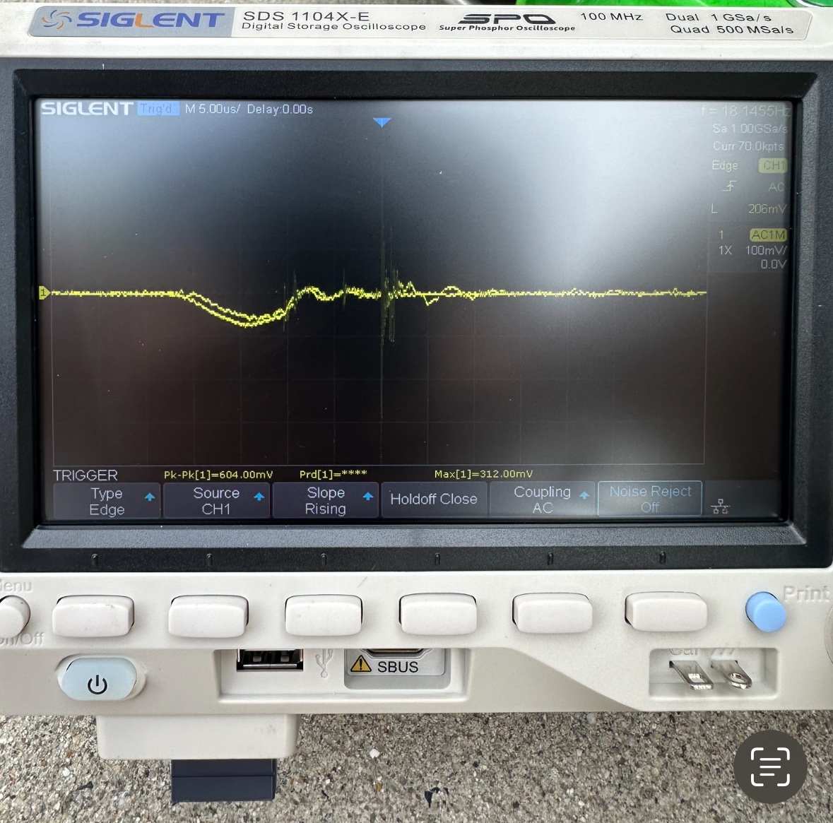

Looks like the scope has pinpointed the noise

Anyway, I probed the OSS connector with the scope and started the truck. Ignition noise, plain as day. If I moved the ignition wires going behind the manifold to the passenger bank, I could see some changes in the waveform. I put my palm on top of the coil, where the wires attach, and could see a dramatic change in the waveform. Disconnecting those ignition wires (rough!) resulted in the waveform vanishing, and me shocking the **** out of myself. I’m sure some of this noise is normal, but the question is how much…and is it getting worse as the truck gets hot.

Above photo is the ignition interference on the OSS circuit, measured across the OSS wire and the signal return.
