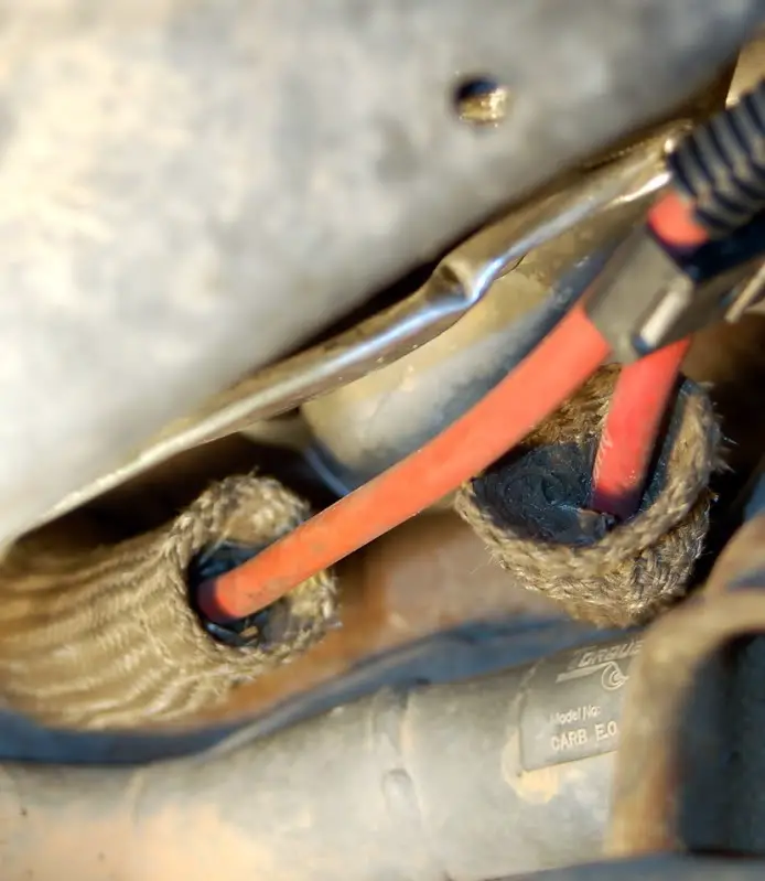

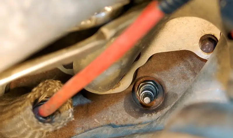

Here are some pics I plan to send to Aurora. It was a tricky place to get good photos, and the clearance is slightly better than it shows in the photos for the most part.
Wire # 3, with boot (on right):
Plug # 3, no wire:
Wire # 3, no sock:
My theory is that because the sock is closer to the header, it heats up and causes more harm than good possibly. I'm thinking of running it without a sock, but want to be certain the heat generated by the headers don't cause the boot to break down worse than it does with the sock on.
I spent a lot of time tonight with zip ties and an extra wire loom and managed to tie the whole assembly (with sock) further away from the header.

I heard from Gary at Aurora just before I left on a road trip (on vacation in BC currently). Sort of a change of page. He recommended I use heat socks sparingly, so I ditched them all. I use 5 wires with a standard issue bend. Two have a 90 degree bend and one straight one for wire # 3.

I checked my wires two days ago and #4 (an old Magnecor I'm using in place of an Aurora for now) showed signs of heat strain on the boot. Sock went back on.
