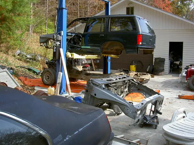

How bad is the 99 frame? I built my 99 using my 93 rear clip, with all 99 wiring. I bought a lift to do the project, I saved maybe $1000 total versus trading up.

I won't really know til I get the bodies off both trucks and do some measuring to make sure the '99 is square. I got all the body bolts out of both trucks so now it's just disconnect everything else and figure out how to lift the bodies with a forklift since I don't have a vehicle lift. I'm thinking weld up some sort of cradle or something. I have an '03 Expedition and I'm planning to get the wiring diagrams for it and both Explorers to see if what you suggest is possible. Swapping to the '99 frame means I'll lose the front disconnect but that's not that big of a deal. I'll likely save the front end of the '96 since theres a lot of new suspension parts and wheel bearings on it.

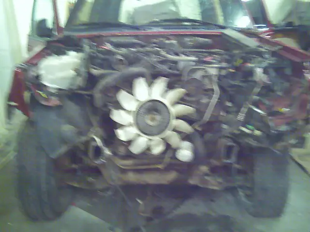

Well here are some low quality camera phone pics of the progress:
Last pic is one of the Kumho's mounted on the truck for inspiration.

Took a good look at the frame today, not enough rust deposit to require blasting. I think I'll just shoot it with POR-15 or Eastwoods product, simply because a painted frame is easier to work under and I want to keep it reasonably nice. I'm hoping to pull the 99 body tommorrow night, strip what's left and get it on my trailer for scrap. Gonna hang the 99 frame, motor and all from my forklift with a chain to paint it easily LOL. Like I said, not resto just decent driver/weekend offroader. Waiting to get the tag numbers back from my brother to see which 4406 he has. Toying with putting my switches where the "kleenex box" goes in the console. Pushbuttons for lights and toggles for BWM and future front and rear lockers. This brings a question though, is an airlocker prefered over a lockright for mild offroading? I've got a Powertrax 31 spline locker basically new in my basement, couldn't hold traction in my old 10sec mustang so I went to a spool.
